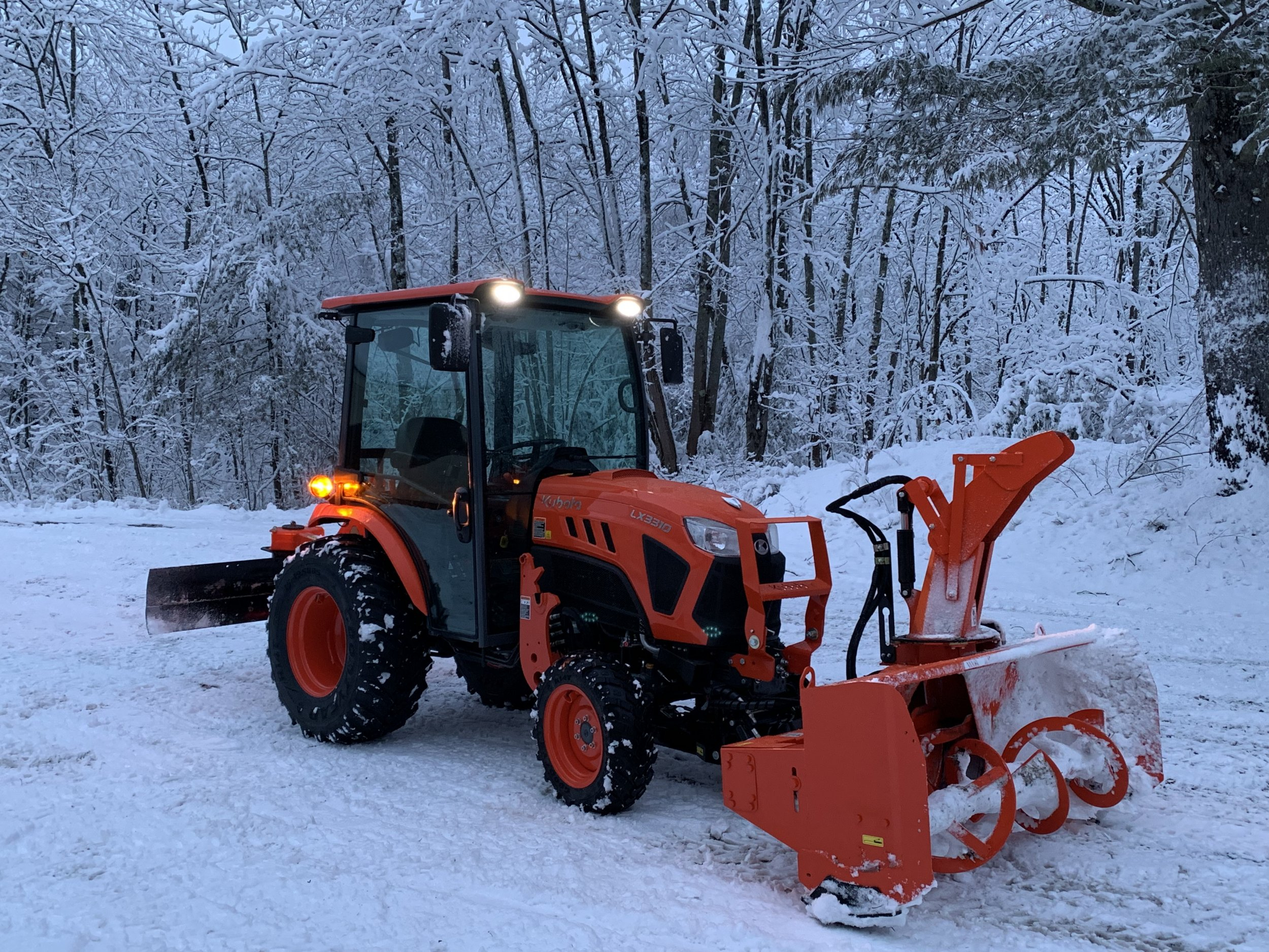

I bought a new LX3310 a couple months back and have used it very little to date with only 12hrs on it. The first snow fell Thursday night and went out and blew the drive and some areas around the house. I then drove to the end of our road to pickup the garbage can and back. I got the single chime/beep every five seconds and the flashing regen light. As I have never had a tractor with this (previous was a MX5100) it took me a bit to get it doing it’s parked regen. My question is doesn’t this seem a bit early? I had expected this maybe at like 70-75hrs based on other posts here and elsewhere but I guess that is dependent on tractor use. It just has me wondering on how often this will occur as while it was not a royal pain, it is disconcerting if it happens like every 10hrs.
Tks for any info as I am still learning about regen and all the details around it. Pic because everyone likes them.

It depends on loads of factors like use, climate, fuel quality, etc. Not something that's dead set on a book or something.
Also being a new tractor, it's most likely caused by short run times at the dealer moving it around, showing to potential costumers or even just you trying the new tractor out, so it didn't really build any heat until now that you put some load on it.
Not something I would worry about yet. The future regens and time in between may tell us if you have indeed an issue going on or not.

Nice looking snow weapon, the kind that would have you wishing for snow!
