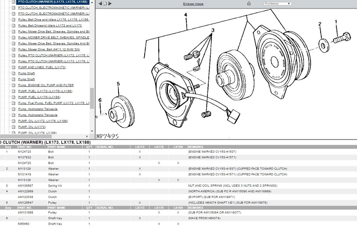

Just replaced the water pump on this beast tractor and a couple of questions has arisen before mounting the clutch assembly.
On the innermost pulley, is there only a pin half the length of the splined groove (or am I missing half)?
Also, what's the recommended thread engagement on the three spring-backed bolts holding the clutch assembly?
Thanks in advance!

Might be a naming difference here, but have attached the PTO clutch schematic from jdparts that may help.
   / LX178 PTO clutch - spline pin and bolt tension?
Thanks.
I see they call it shaft key, and just by judging from the drawing it looks roughly a third longer than what I have. Nothing on level of engagement on the the clutch bolts, tho?
   / LX178 PTO clutch - spline pin and bolt tension? #6
I don't have the tractor you are working on so I can't give any detailed info, however typically, thread engagement only needs to be equal to the thickness of the bolt. So if its a 3/8" diameter bolt (10MM for you), then you only need to engage the threads 10mm.
