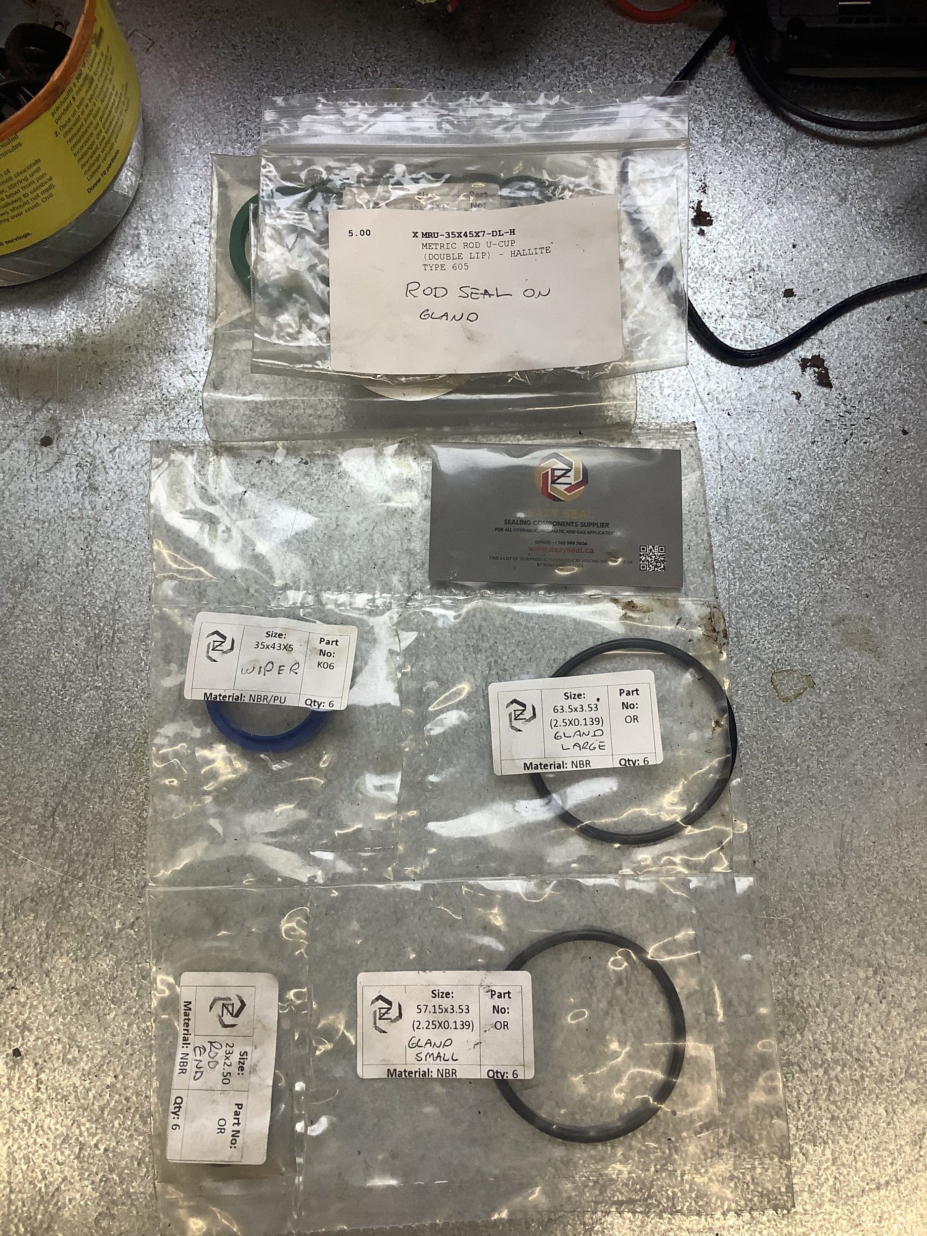

Just replaced my LW8 backhoe seals but NOT including the main rod seals which I couldn’t remove and seemed in decent shape anyway. For those replacing the rest being: rod o ring under the rod piston, both gland large o rings, gland wiper and the gland U cup oil seal (most important), See the accompanying photo for the sizes. I ended up ordering from easy seal in Canada. Note the rod end o ring is 2.5mm, hard to see. I advise checking your seals against these measurements just in case of variations.
BTW, free apps for sizing o rings are available which is what I used like Olypsys.
Cheers,
Don B
   / LW8 Backhoe gland and rod seal sizes
#2
Slight update for the o rings on the lw8 hydraulic lines to cylinder seals. Mine measured 8x2 size.
