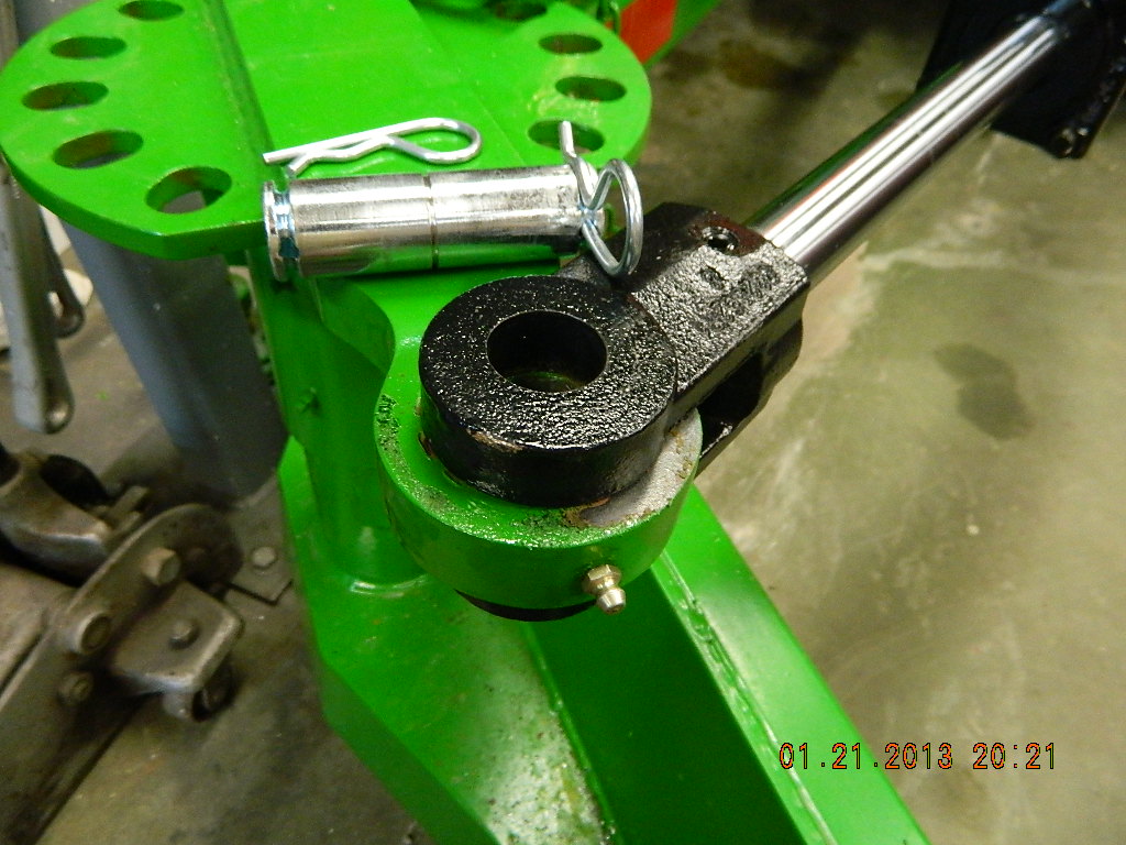

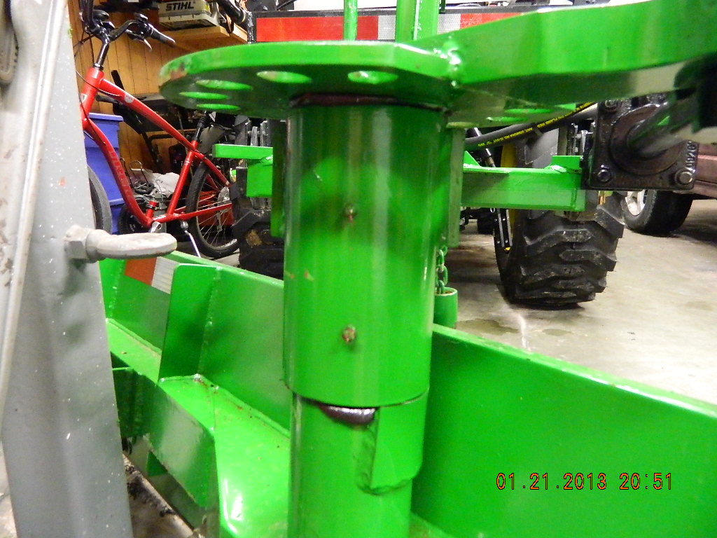

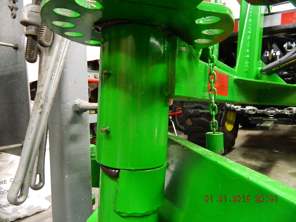

In less than 10 minutes you can drill out the hole(s) tap some threads and install the zerk fittings.
This is the rear blade for my tractor.
I decided to lubricate the pivot for the rear blade and the cylinder clevis pins.
I drill a 1/16" pilot hole and then a #3 drill deep enough to tap with a 1/4"-28 tap.
The cylinder clevis pin received a grease channel all the way around the pin.
The grinder was held in the vise by the grinder handle and I rotated the pin cutting a groove.
It just that easy.
Tom

What is the green chain hanging on the right side in the last picture?
   / Lube Your Shaft - It's Fun and It's Easy #8
It looks like the pin that holds the blade in position.
