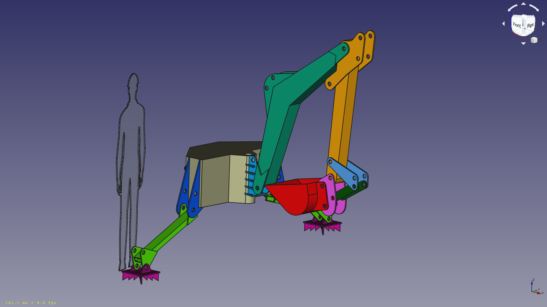

What I am really trying to find is the size/timings of the cylinders for a backhoe that I am designing. And I want to make a good estimation on the hp availabilty and if it worth to use a pto pump instead of the remotes.

You are exactly right!! But, the problem with these calculators is that they assume that the torque is constant as in a electric motor. With a gas or diesel engines thats not the case and one has to downsize the pump in order to actually handle the load. But another reason that I went deeper into this is because I do not want to run the tractor at the max power (at @2600 rpm) but at just above its max torque @1800, which conveniently will be more quiet too. I concluded that despite the fact that the 7.62ci is just above my tractor limits at 2600rpm(with a safety factor added) , its adequate to use at 1600 rpm, because the torque is higher (and hopefully at 1800rpm too.)
I am pretty sure that I will go with the 7.62ci. At 1800rpm I get 387rpm at the pto, 12gpm with the 7.62ci.
And the last reason is to see if I can make the backhoe stronger with wider cylinder bores. The stock LS backhoes are using 2.5" cylinders. If I can go with 3" without sacrifice speed, why not. I can also make longer backhoe.
Anyway it will take a while I just started a rough design 3 days ago :) :)
