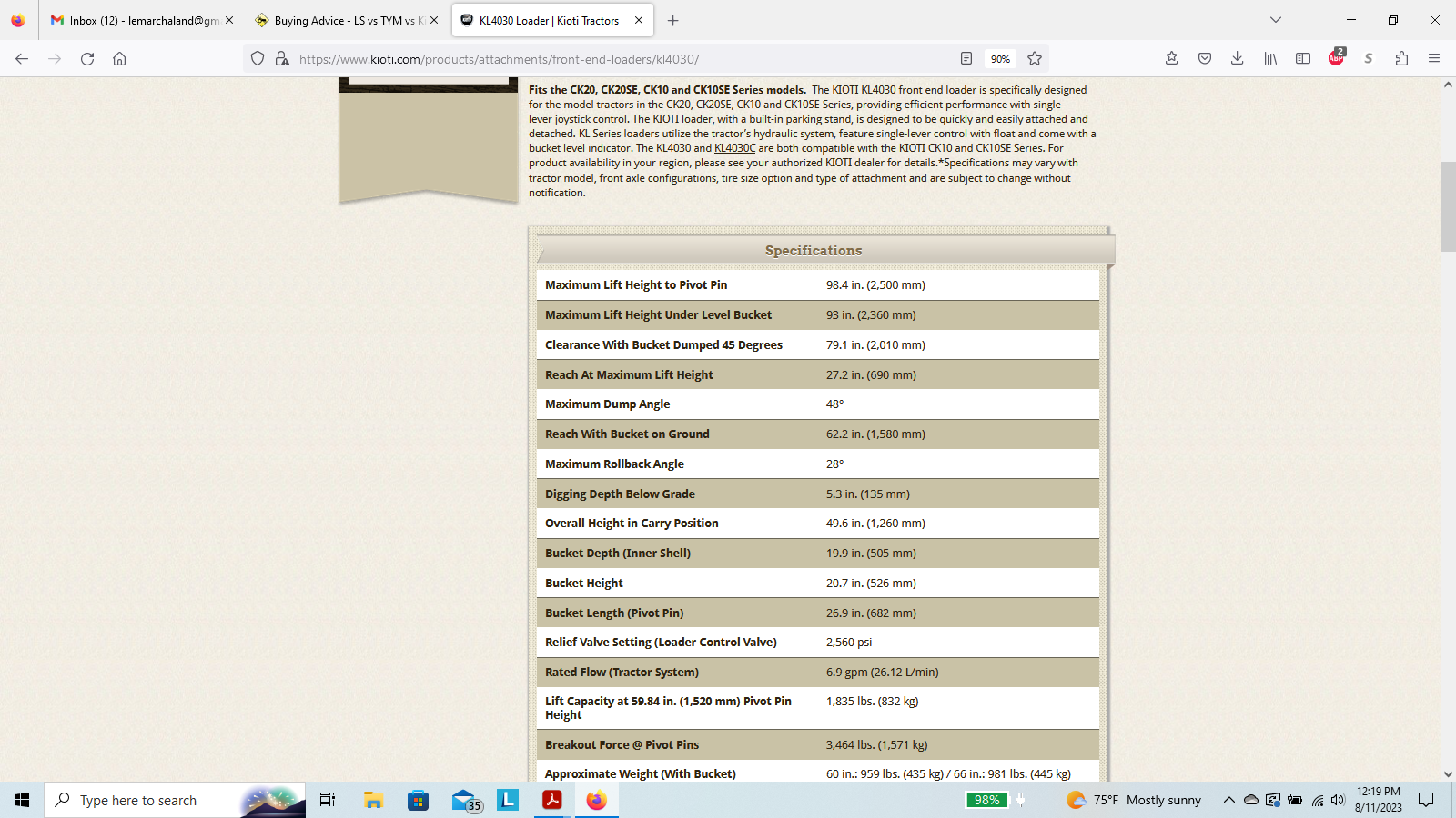

The Kioti CK20SE series tractor which will spec out the same as the non SE models and the older CK10 series will spec out the same in hydraulic flow and pressure through out the series.
From the CK2620 to the CK4020 which is 11.33 gallon per minute flow, the tractors all have the same 3 point capacity of 1621 pounds at 24" from the hitch.
Kioti tractors and loaders for the CK 2620; break out at ground 3464 pound, Lift Capacity at 59.84 in. (1,520 mm) Pivot Pin Height 1,835 lbs. (832 kg)
So two possible loaders for the CK 10 or 20 series tractors which are used on all the tractors in that line regardless of engine HP, so lift and carrying capacities are the same through the CK series of tractor on both loaders and 3 point. And the loaders do have more capacity then the 3 points do.
