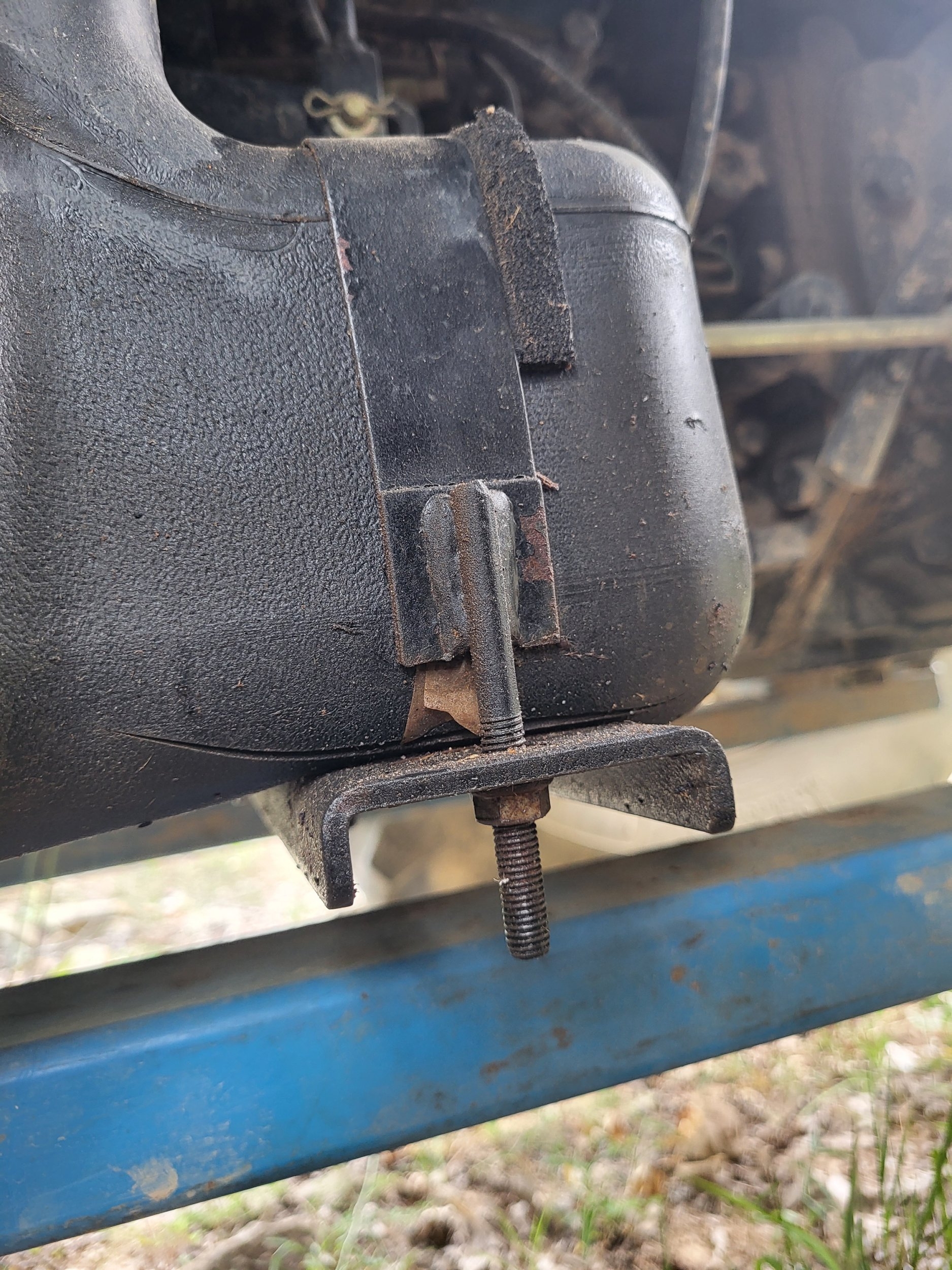

There were some Montana models built by LS with the tank up under the hood that leaked also. Not sure of the cause on those but likely same issue with bolt attachments built into the tank. The mod puts in an additional support to hold the little skid plate. I still have it in the box with the new tank. My old repair to the tank using JB weld is still holding so my new tank is still setting in the shop awaiting the day the JB weld fails. I "adjusted " my tank mounting prior to the new tank arriving, buy welding an angle iron bracket with solid bottom of 1/8" plate from front of the tank to the back support for the tank. THere is still a little bit of the back part of the tank open but not much. I then put some 1/2" rubber mounts under the support positions and bolted it all back in place. If the old tank ever starts leaking, it will be a simple task to replace it by just removing the bands, unhooking the fuel gauge wire and putting in the new tank. Since I did all the work on my tractor, I kept the old tank. So far the dealer hasnt asked for it back even though when I picked up the replacement, the clerk said he needed the old one back just in case LS audited him. I guess no audit yet.

According to the LS representative that emailed me the information, the new design did away with the screws going into the tank. So if your tractor still has the plate under the gas tank with 4 screws into the plastic tank, you have the old design and the dealer is supposed to retrofit. I assume for free.

I was loking at mine, I think it has the modifaction but I am not real sure. It is a 2011 model year.
Mine is 2007 I think it has the mods but still problems
