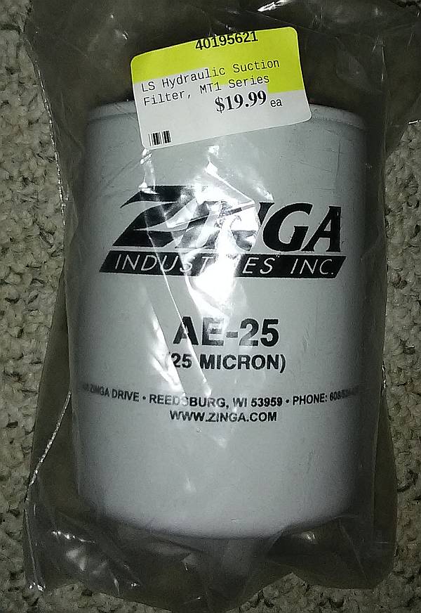

Search doesn't work real well. Is there a cross for the MT125 Main Suction Hydro filter; 40195621. One that won't be a warranty problem?
   / LS Tractor Oil, Gas, & Air Filter Information #317
This is the main suction filter supplied by my dealer. Comments?
   / LS Tractor Oil, Gas, & Air Filter Information #318
For us owners of 3025(H) tractors, that goes to the hydrostat system. Our main Filter is 3 times that size. Great filter and one specified by LS for our tractors. Not cheap though
