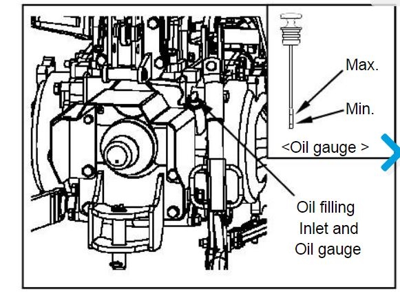

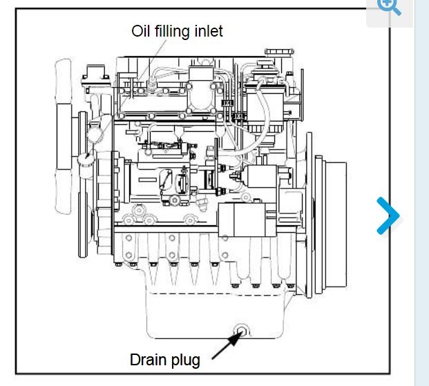

Hello, I have a newer tractor but it doesn't say in the manual what these reservoirs are. Someone please tell me what these are. Thank you
When you said a newer tractor I thought you meant a current model, not a R4041 from 2011. The newer models have a different engine. Not sure where you were looking in the manual, but this information is in the manual in section 5. Here are pictures from the R series manual of transmission and hydraulic check / fill and engine oil fill. It's not a pump, it's just an engine oil fill port.

Had a 2011 R4041 (and now a 2017 XR4140) ... as indicated by all previous posts I can confirm the outlet at the rear of the tractor is for hydraulic and the front outlet is for engine oil.
