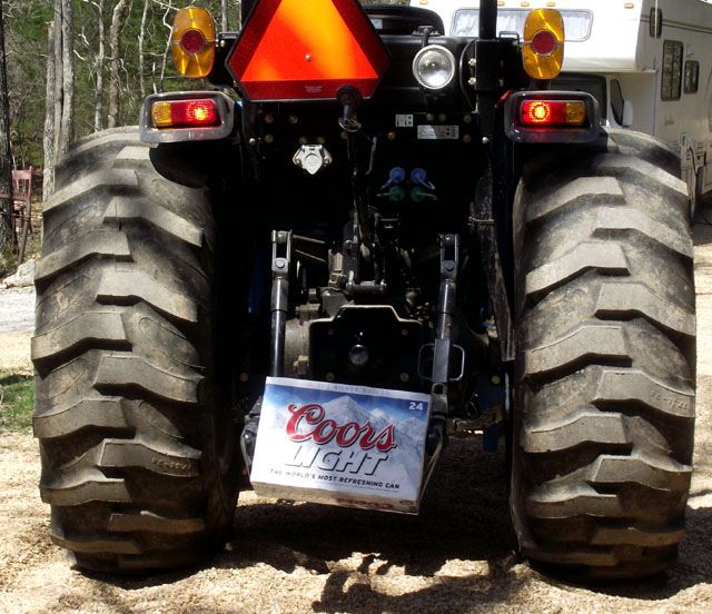

I have a concrete project on the to-do list so I was considering building a 3-pt ballast with any left over mix.
Now I'm wondering just how much ballast I should be shooting for.
Went back to Operator's Manual to find weight information:
Weight
Notes
LS R4041H
3,615
LL4101 Loader
1,100
72" Bucket
300Estimated
Operator
250ditto
Subtotal: Empty Weight
5,265
GVWR
6,631Op Manual pg 4-18
Available Payload
1,366
1/2 yd of Gravel
1,350Bucket Capacity 15 cf
Remaining load for Ballast
16
So I guess I don't need the concrete after all.
That ought to do it!
Bob

Great analysis.:thumbsup:
Many people don't consider that every vehicle has a GVWR. Let alone adhere to it.
Loaded tires would seem to be a must in this case.

Great analysis and great solution! I like your thinking! :drink:
   / LS R4041H & Ballast Analyst
The Koreans don't use the term GVWR but 'Technical Maximum Permissible Mass'.
So the math works out to a payload of 1,366 pounds yet the tractor is rated to lift something over 2,500 pounds from either end. It's a conundrum where I'm hoping someone smarter than me can explain. They have a 'Restrict Operation' caveat that the front axle has an 'Intermittent Maximum Permissible Load' of 4,393 pounds (1,488 pounds over the 'GVWR' rating for the axle).
Your advise on loaded tires makes a very good point! That weight is on the ground and not on the tractor. Up until now I've always been on the side of 3-pt ballast that would use the rear tires as a fulcrum to unload weight off the front axle. Now I'm less fanatical in my beliefs. I guess that is always good. . .
Thanks for response,
Bob

Er, I just looked at your rear ballast. Considering you started out on the "light" side, don't you think you need a bit heavier load? Perhaps regular Coors, or at least another case of the Coors Light? :laughing::thumbsup:
#9
Nah, this looks like another idea that isn't panning out.
The problem with that liquid is that it shifts around too much during the course of the day. It starts off on the 3-point in the morning. Migrates up behind the steering wheel during the heat of the afternoon. And by the end of the day most of the weight is on the ground much like loaded tires. Well, close to them.
All that shifting of the center of gravity makes the tractor steer funny.
Now, beet juice? That crap will last forever.
Bob
