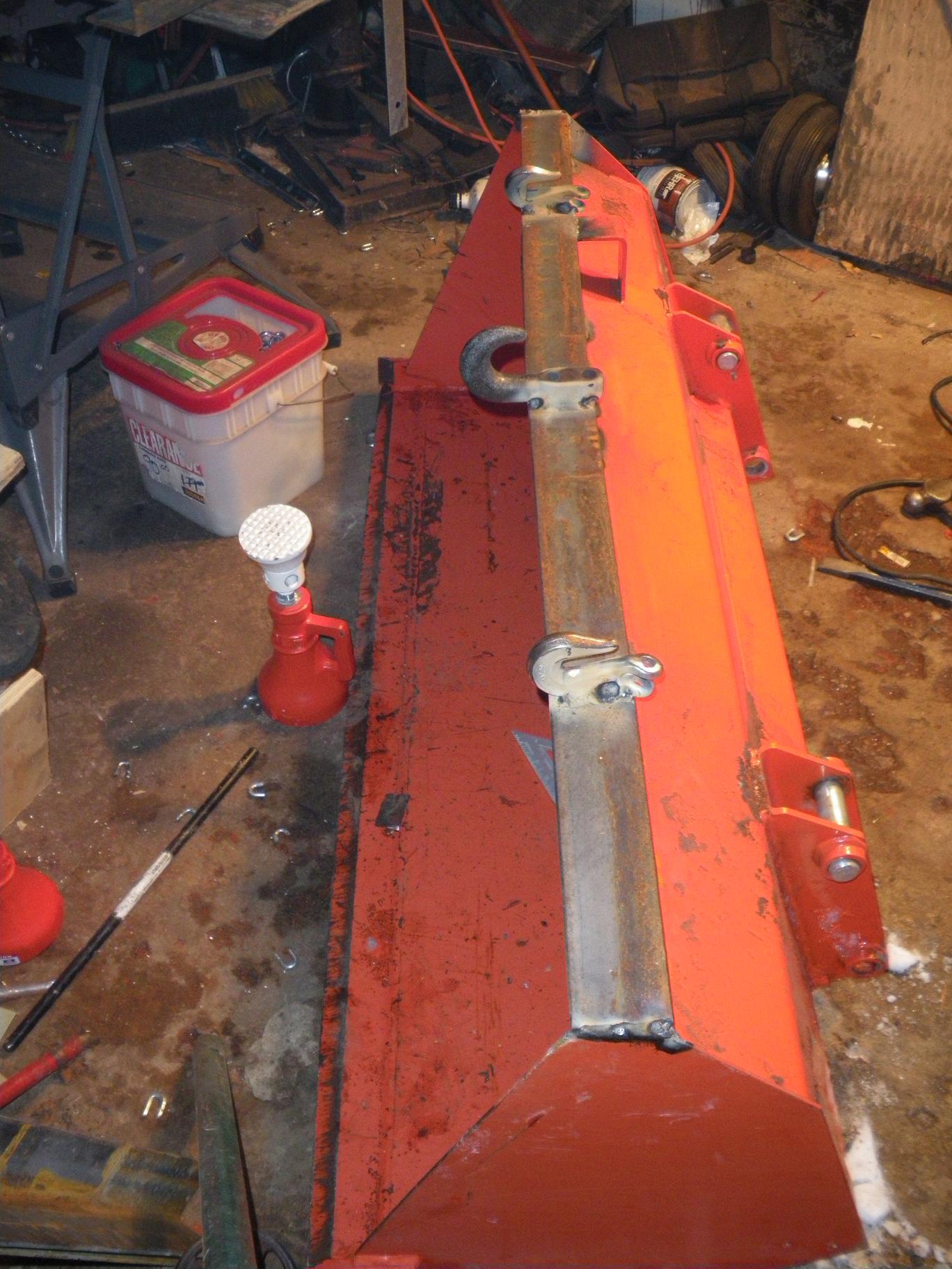

I like a combination of grab hooks and a tow hook for a 4x4 truck. The Tow hook is more friendly with wire cable loops and a necessity for nylon recovery and other ropes. depending on how solid the top of your bucket is, you might want to reinforce it as well.

My LS dealer sells the weld-on grab hooks. I put a large slide hook in the middle, and the grab hooks at the corner. It works great to throw a chain over the slide hook and pull up the slack and lock it down in one of the grab hooks. I have posted pics of it before (see below).
