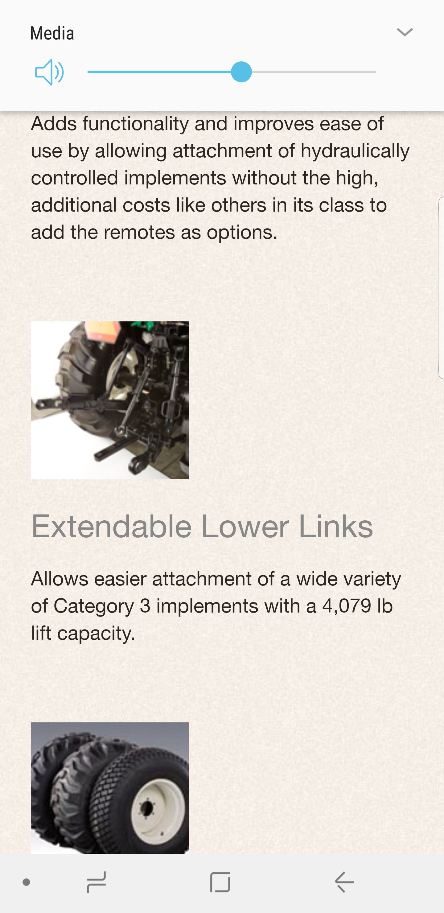

This is where I found it.

It really doesn't matter to me one way or the other. I'm not here to debate the fine print in a sales brochure. Thank you for your time and input, but like I said in my original post, I'm looking for folks with real world experience with either or both of these tractors. Anyone?

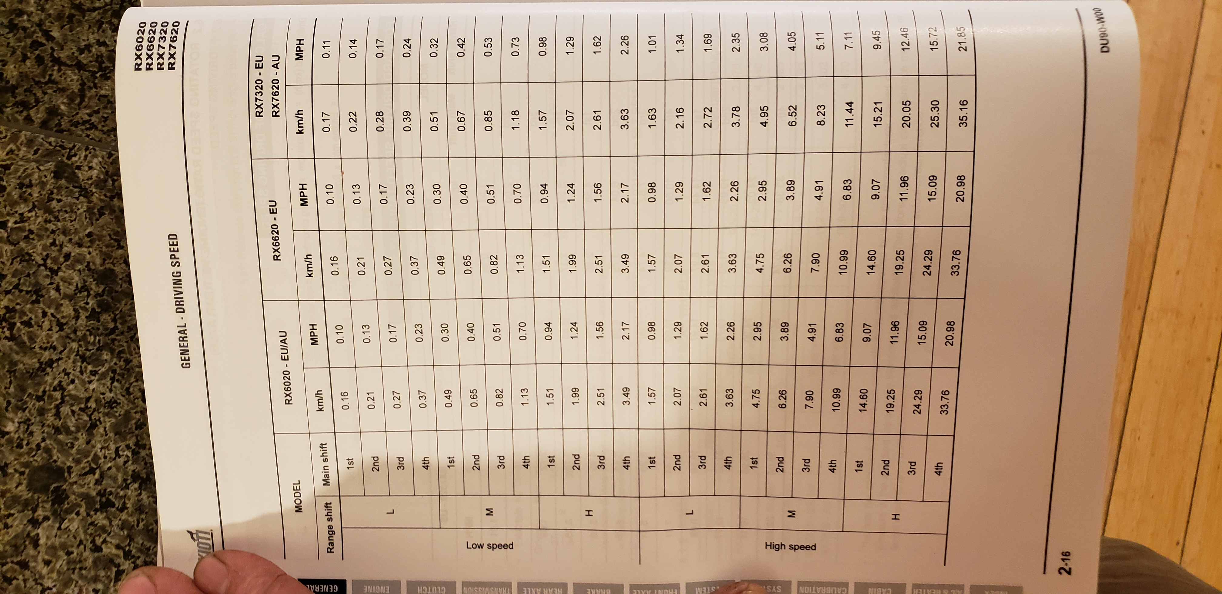

Speed table / chart for kioti rx series with creeper gear

Thats pretty handy! That actually illustrates what I was saying pretty well...the first 10 or so gears of the creeper gear are so close together there is not a distinguishable difference between them. That sure does make for some low gearing!
