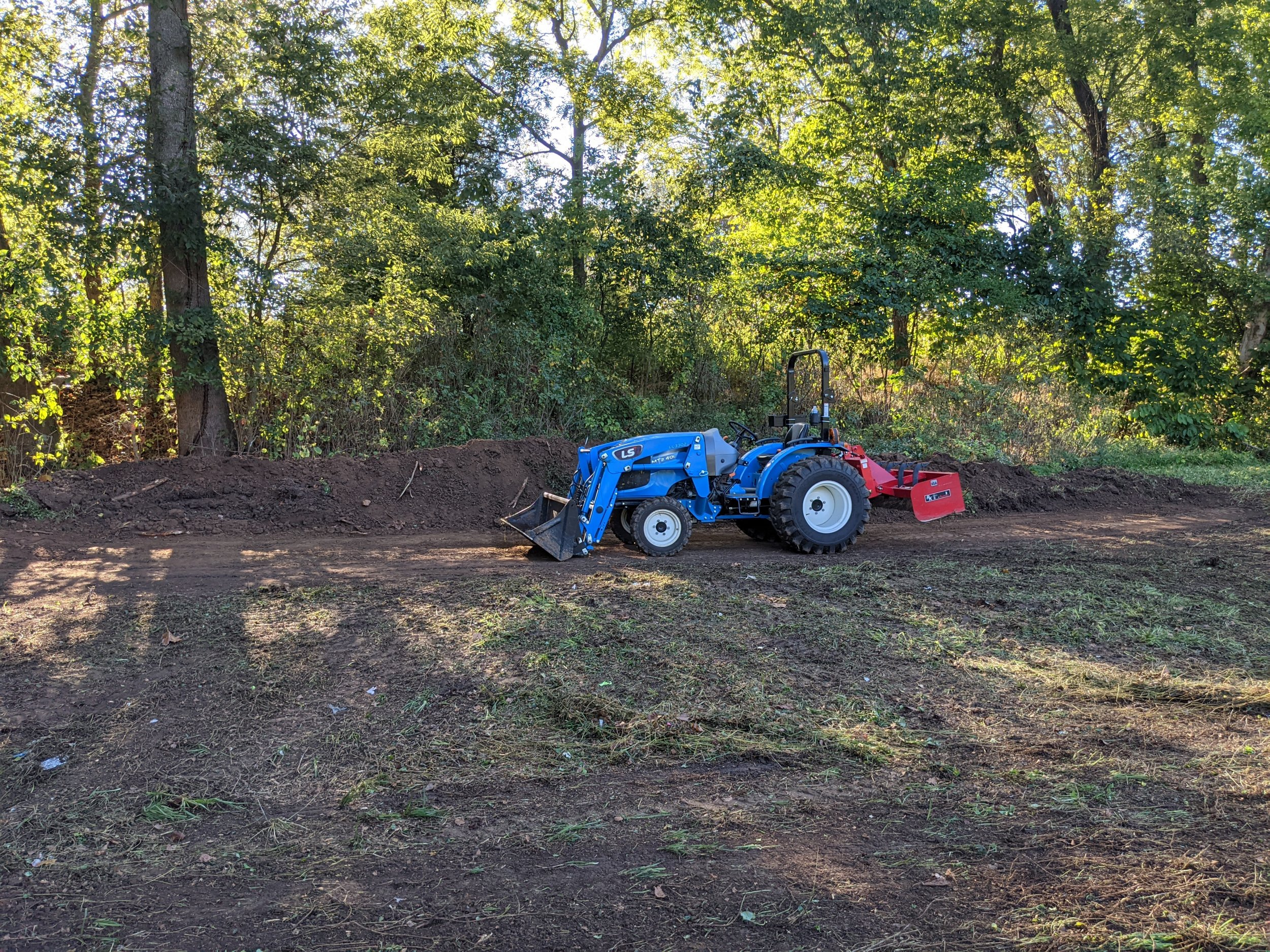

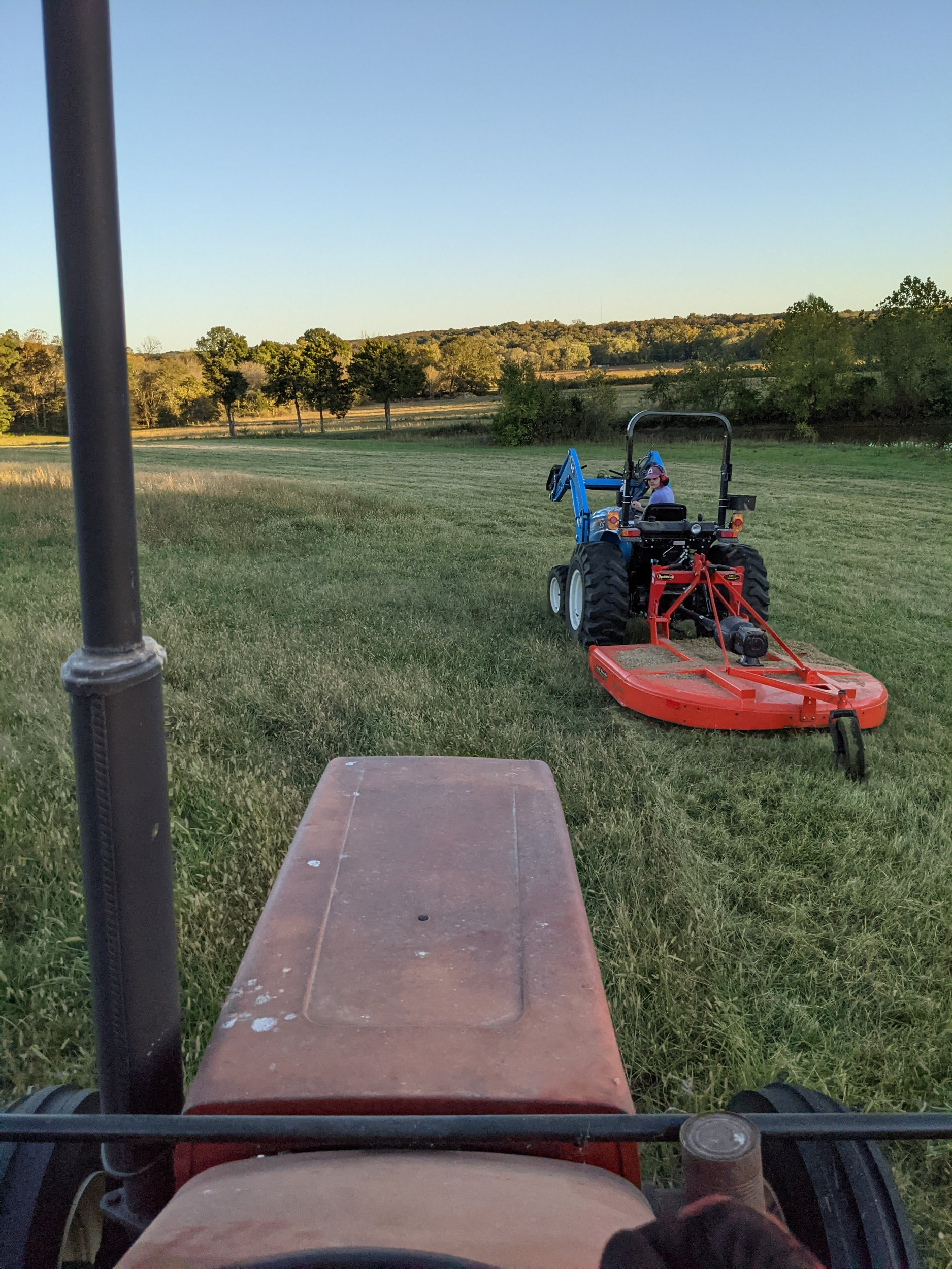

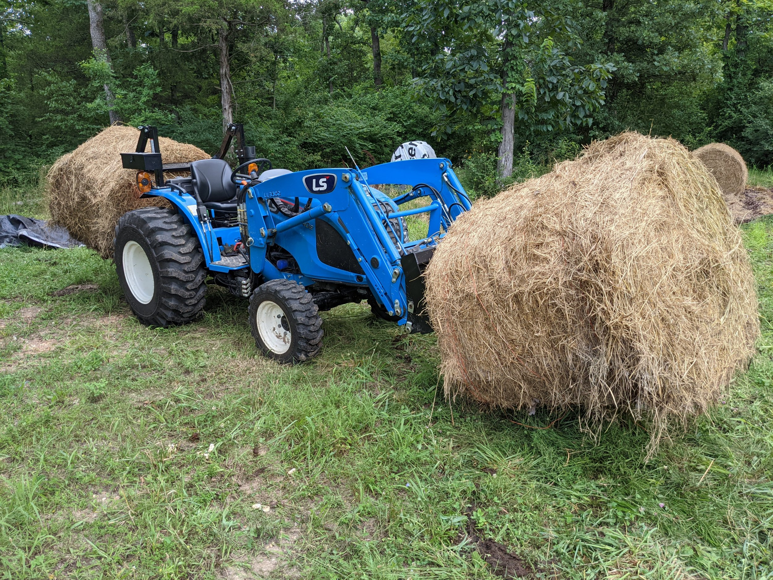

Love my MT240HE so far, I'm at ~180 hrs. I have used the backhoe a lot, I've used a 5' Bush Hog BH215 Brushhog on the deer lease, A Terraforce 62" tiller in the garden, A 6' 3pt Disc on the deer lease, A 60" EA grapple a few places and it has performed great. If the MT3 line is in the budget, go for it, you won't be disappointed.

I too have a MT240HE. My 11 year old daughter is a novice operator as yourself and has no problem using it confidently with my direction. It has plenty of power to run a 6ft cutter and handle many other jobs around the farm.
