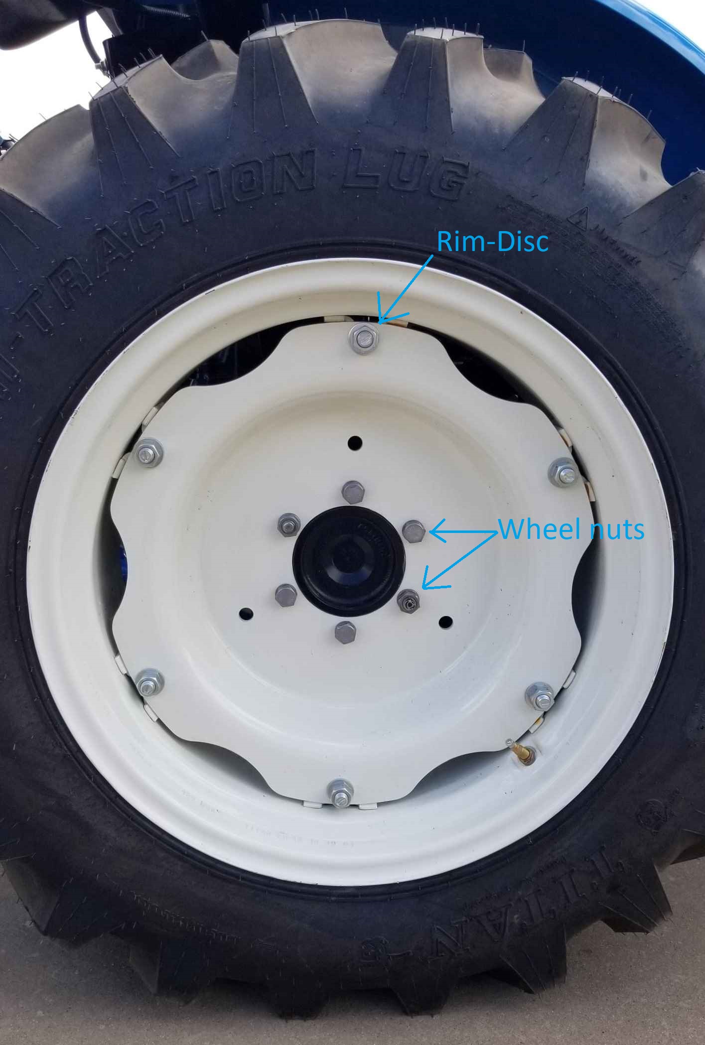

Thank you for bringing that to may attention. Being an old car guy (working on cars since 'about '66), I do not understand the nomenclature they used. My wheels have two nuts on studs to make it easier to mount a wheel, and the rest are bolts. What do they mean by "rim-disk"? And those wheel torque figures in the manual are certainly higher than for the same size 8.8 hardware used elsewhere.

LOL! Yeah, a lot of it has to do with the translation that was done.
Rim-disk is the nuts and bolts that hold the outer edge of the center wheel section to the actual rim the tire is mounted on.
I actually took a sharpie and wrote 165 on the "disc" next to the valve stem on the rear wheels so I can quickly check them with a torque wrench without getting the manual out.

Thank You, Bearsixty7 for the photo! I thought the manual was talking about a two-piece rim but there was no illustration to go with it. My 240 has welded rims, and thus the confusion! The chart of torque values in the manual must have directly converted Newton Meters to lb./ft. because they give the rating for the M14 8.8 grade bolts as 97.6-108 lb/ft. Very literal people. They could have easily rounded up as in my 50+ years of working on vehicles I have never see a torque wrench that was adjustable in tenths of a pound.
