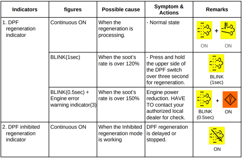

Looks like the manual regen switch may only work if the DPF soot level is over 120% and regen light is blinking once per second.
/ LS MT240 Regen info. thread
No, that's just what the recommended action is. It can be forced anytime, just not something you want to do often. I had no lights on the other night. I was just going on the previous regens occurring about every 25 hours and thought it had to be close to needing one but since I hadn't used it for more than an hour at a time, I figured it never got hot enough and was worried that it might try to go into a regen right after I started it and it wasn't warmed up but it appears that it looks at several sensors or conditions first.
I will let it just do it as needed from now on from what I learned.
I wish it displayed the % full like my F350 does, then I could possibly plan for it or extend the time it's worked.
