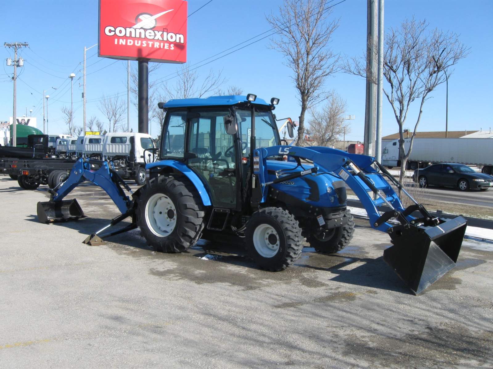

Does any body have the LB3501 or LB3502 Ls backhoe? Just looking for opinions on quality, power etc..Or even how much they are( have yet to call my dealer about it)..My thoughts on it are it is is going to cost more than 10g than i might just buy an old full size TLB..Here is really the only pic i could find of one on a 5020c like mine..Definitly like the look of it and it looks like there is some beef to the metal boom/ dipper, etc..
