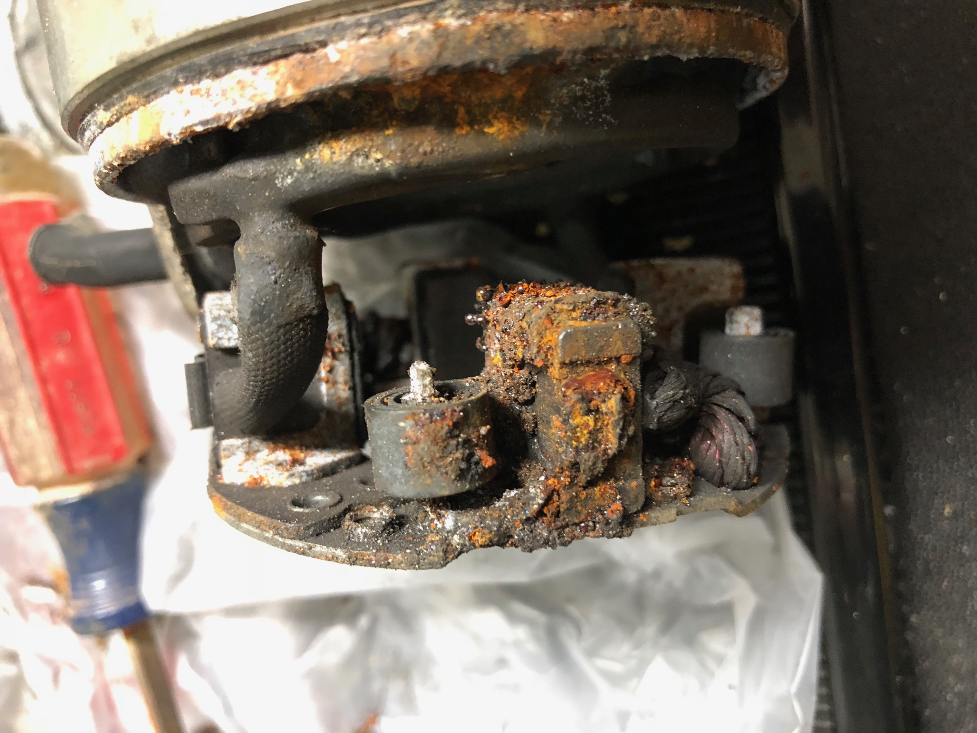

Howdy all!
Went to start the tractor and it acted like a weak battery. The solenoid would click, and the motor would bump slightly. Put a jumper on the battery and no improvement, removed and cleaned the battery, ground and starter connections still no go. Replaced the battery and still the same. So I removed the starter to bring home and take it apart.
This is what I found:
It looks like water has gotten in the starter (apparently not very water resistant) and caused rust and corrosion. I checked online and found the price for a LS replacement starter is $1500.00. Okay I admit it, I got STICKER SHOCK!
My current plan is to try a starter rebuilding shop but I've never had to use their services before and am not sure what to expect. Anyone have good/bad experiences they care to share? Other alternatives before I man up and pay $1500?
/ LS 5020 starter problem #2
1500 dollars for a starter???
yeah, I'd have it rebuilt too. I'd almost bet the farm there are pretty ordinary parts in there, and the sticker shock price is pure and simple because it's on a tractor
/ LS 5020 starter problem #3
To the rebuilders for sure. They are reasonable and usually know what they are doing.
/ LS 5020 starter problem #4
I would either have it rebuilt or find a replacement. If you have it rebuilt you will likely run into the same problem in the future. It will only be a matter of time before the corrosion starts in again. I would look into replacing it with something better? Do some research and find a suitable replacement that is not LS. $1500 seems a bit extreme.
/ LS 5020 starter problem #5
A good rebuilder will also be able to tell you what else that starter will fit. We have one in my area that I would not use again, but there is one about 60 miles away that is great. I had the same starter fixed at the first place and it worked for about 10 minutes. The second place fixed it right for less than half the money and it lasted over 15 years until I sold the tractor.

I promised to update this thread.
I took the starter to a starter/alternator rebuild shop in Houston. They did fix the starter for $135.00 and it works, lot cheaper then buying new. Now will see if it will last. I sealed all of the potential areas where water may leak in using RV rook sealant (because it is what I had). It's capable of handling the hot roof temperatures so I think it should handle the engine compartment temperatures.
Tried to get some additional information about the starter from the rebuilder, such as who else uses this particular starter, but english was not his primary language so I didn't get too far with that.
Again thanks to all who offered advice. If this starter fails in the short term I'll let you know.
