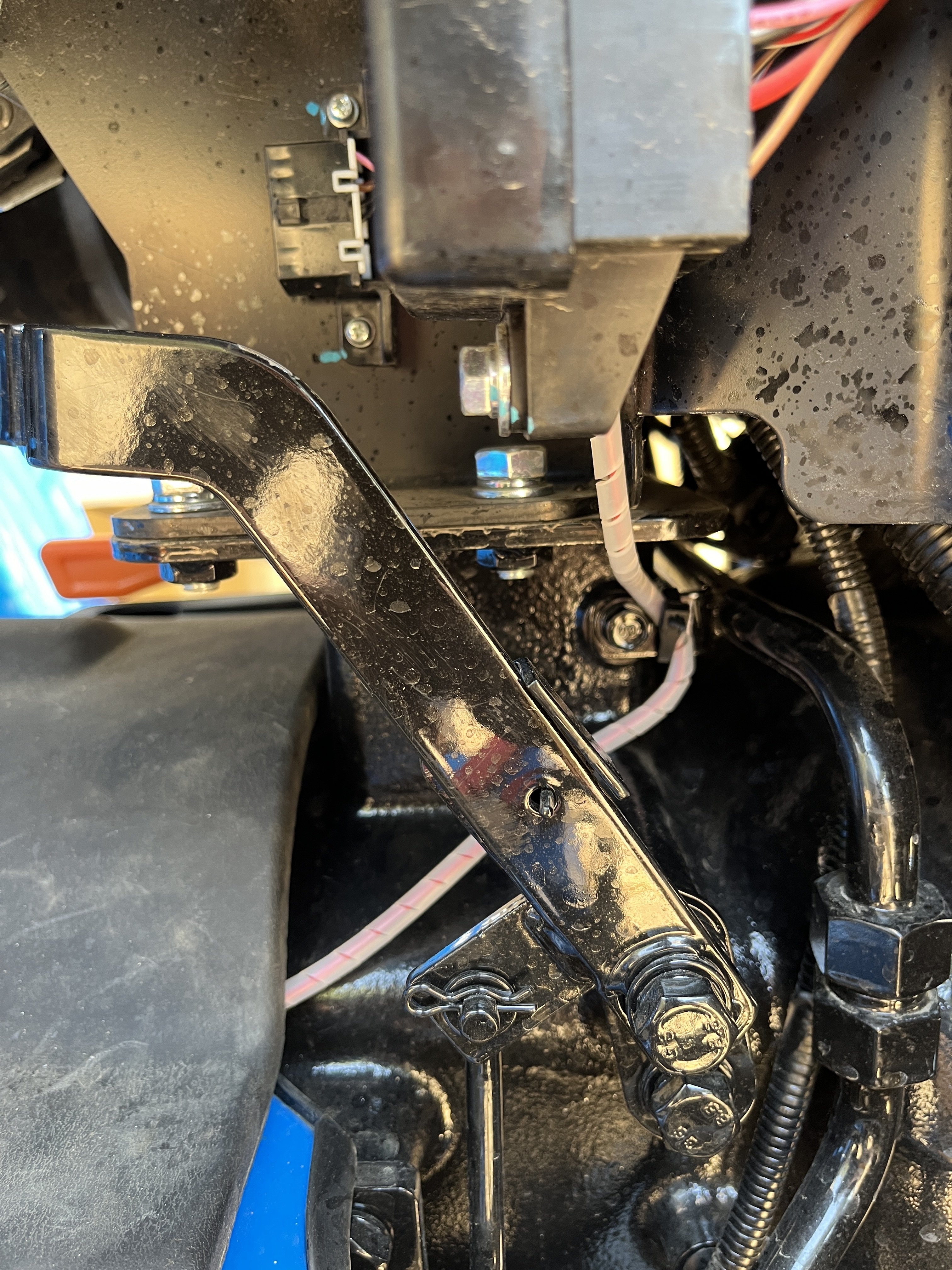

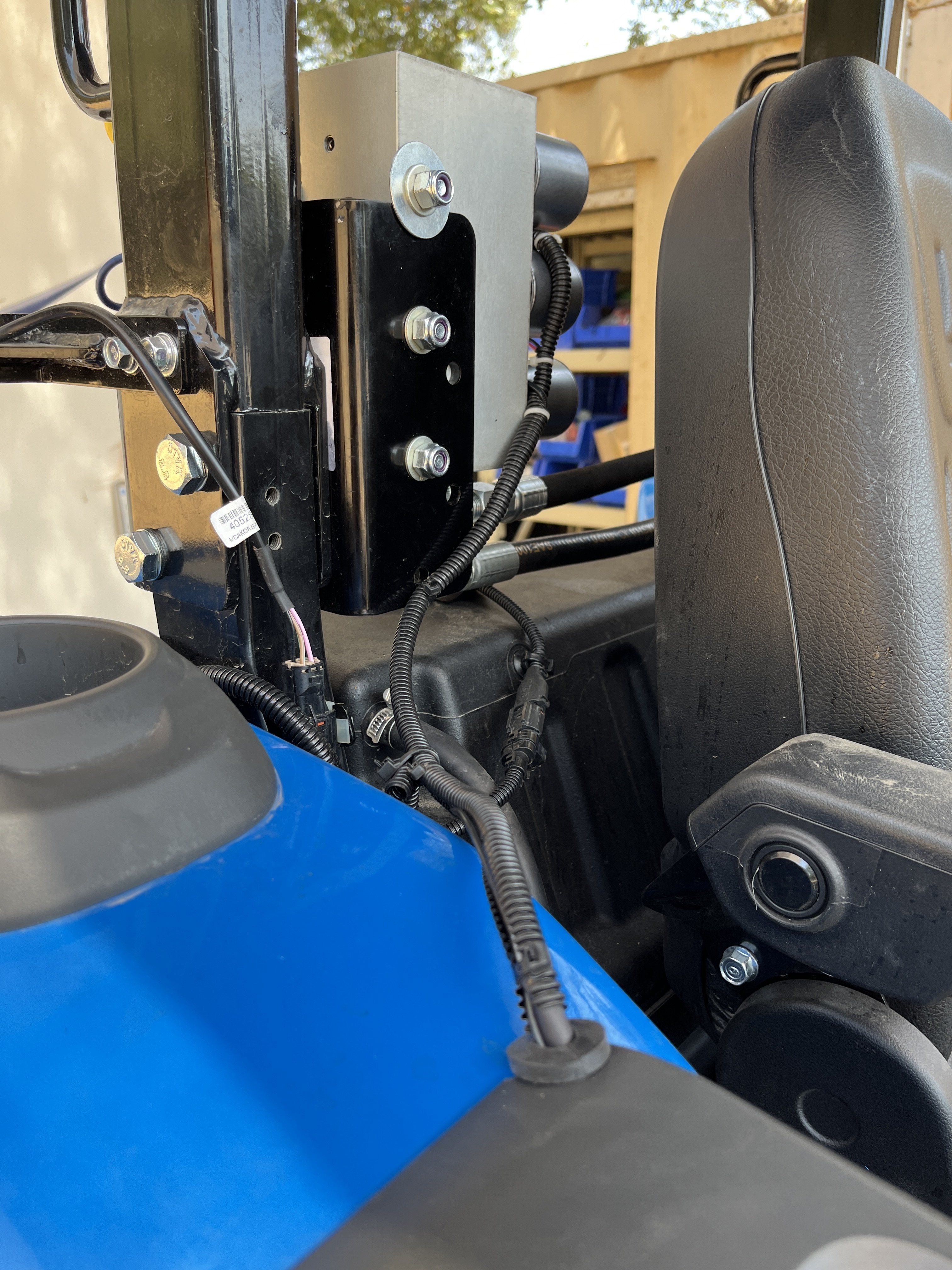

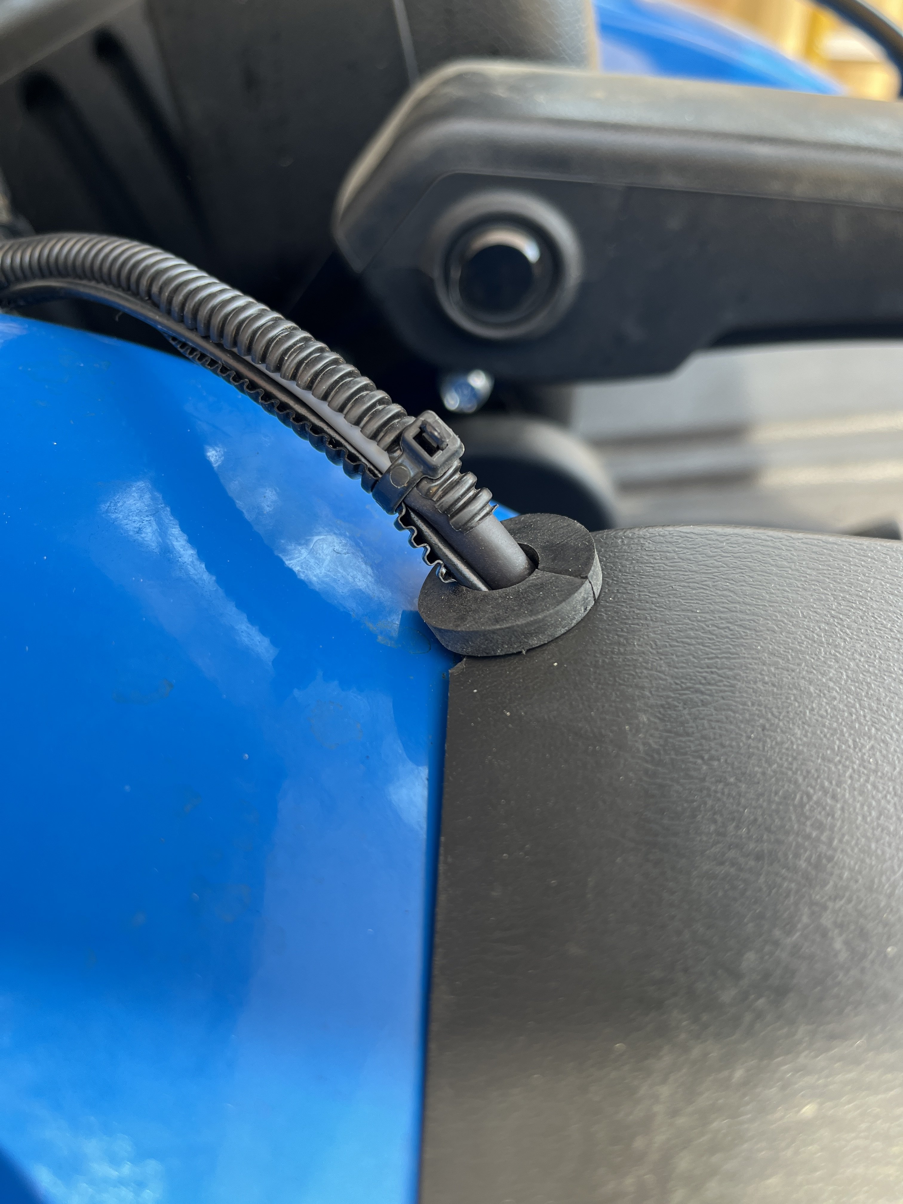

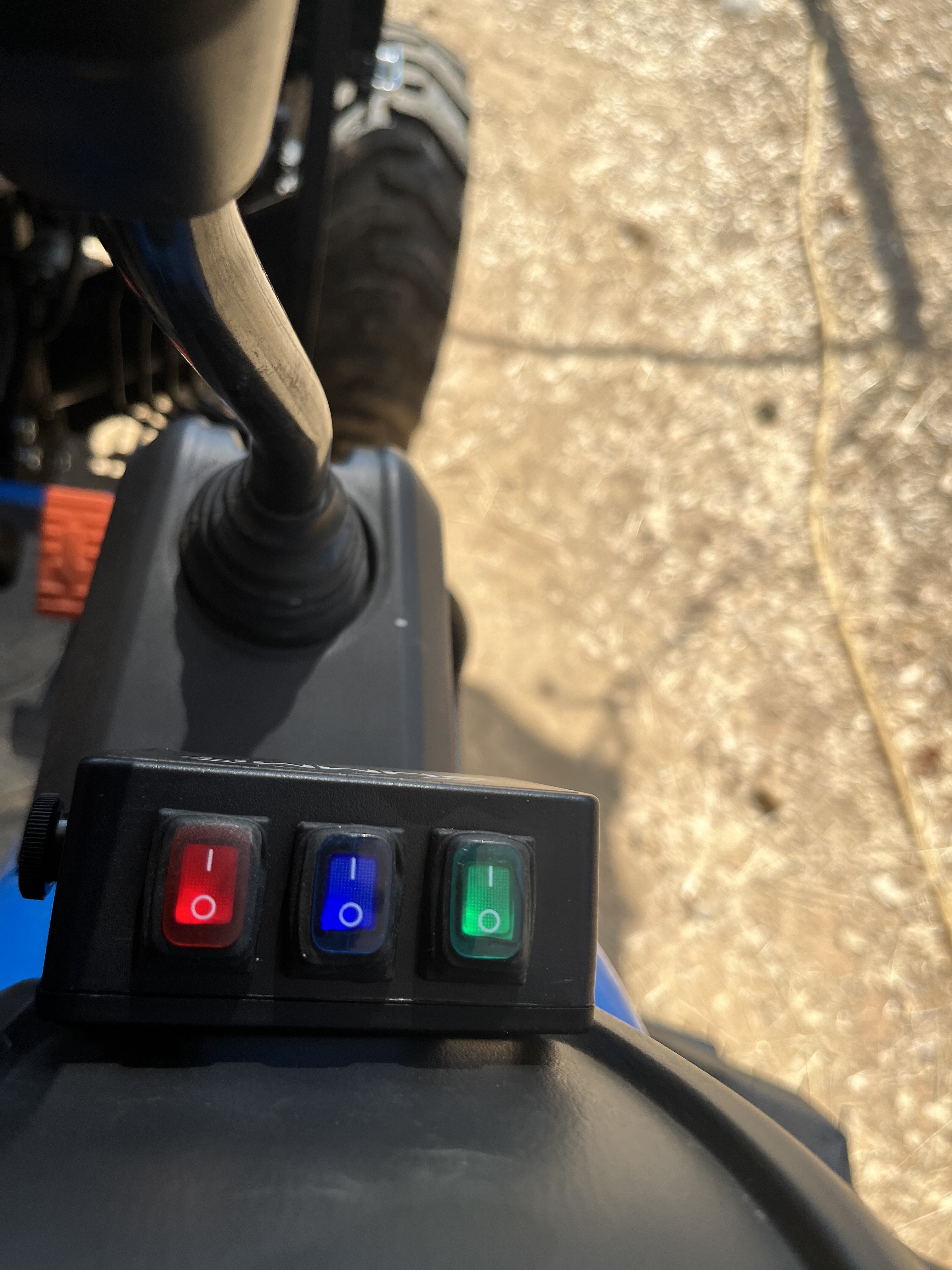

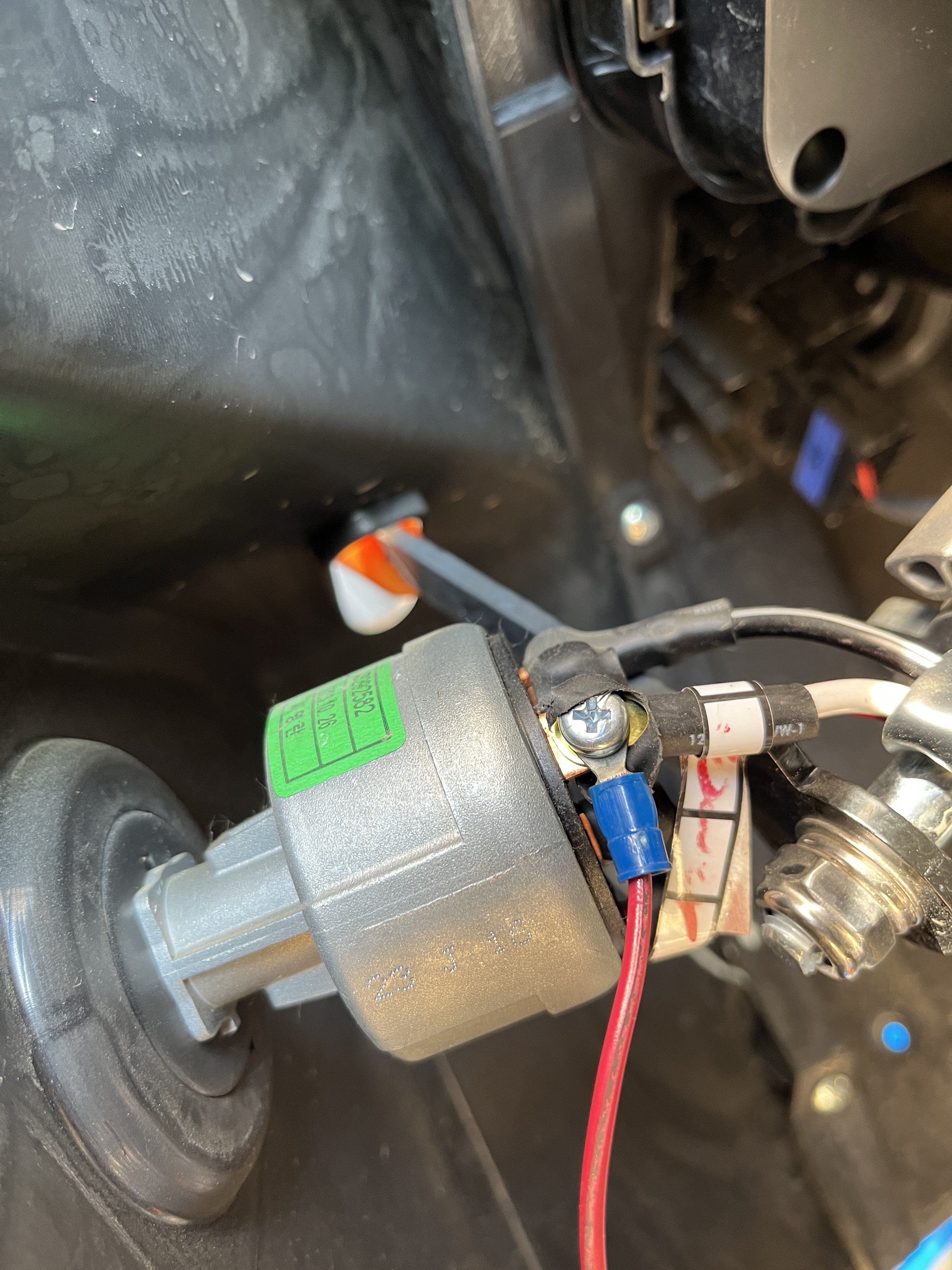

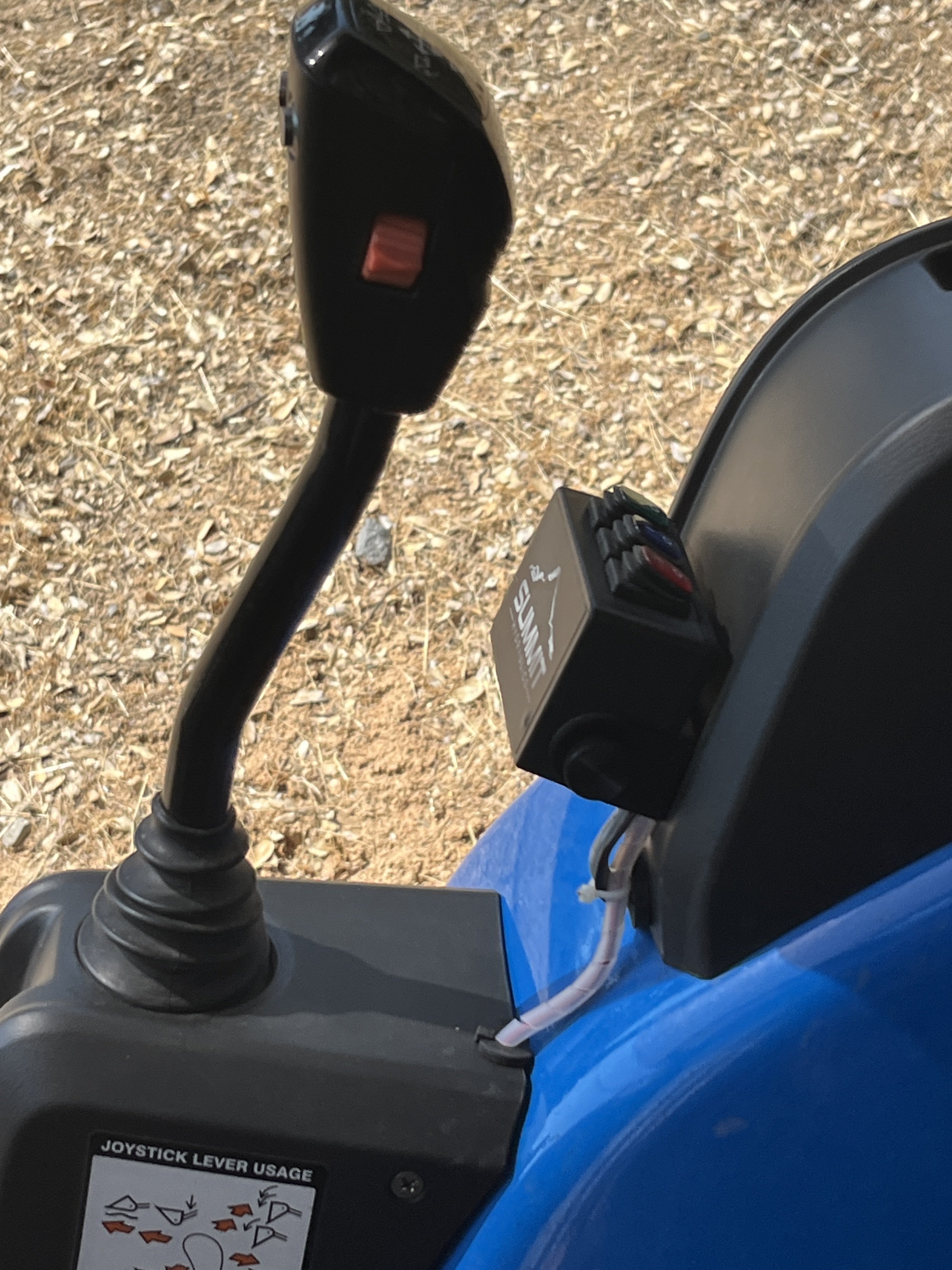

I got my hydraulic multiplier mounted, and the wiring is done. Cylinders are arriving next week. Supposedly my kits for another rear hydraulic and 3rd function kit are supposed to ship Monday from LS. I've been told they are moving the parts warehouse, which is why there are long delays for parts. I'm not sure they have gotten it straightened out as yet.
Wiring connections Routing extra length of wires under the side cowling.

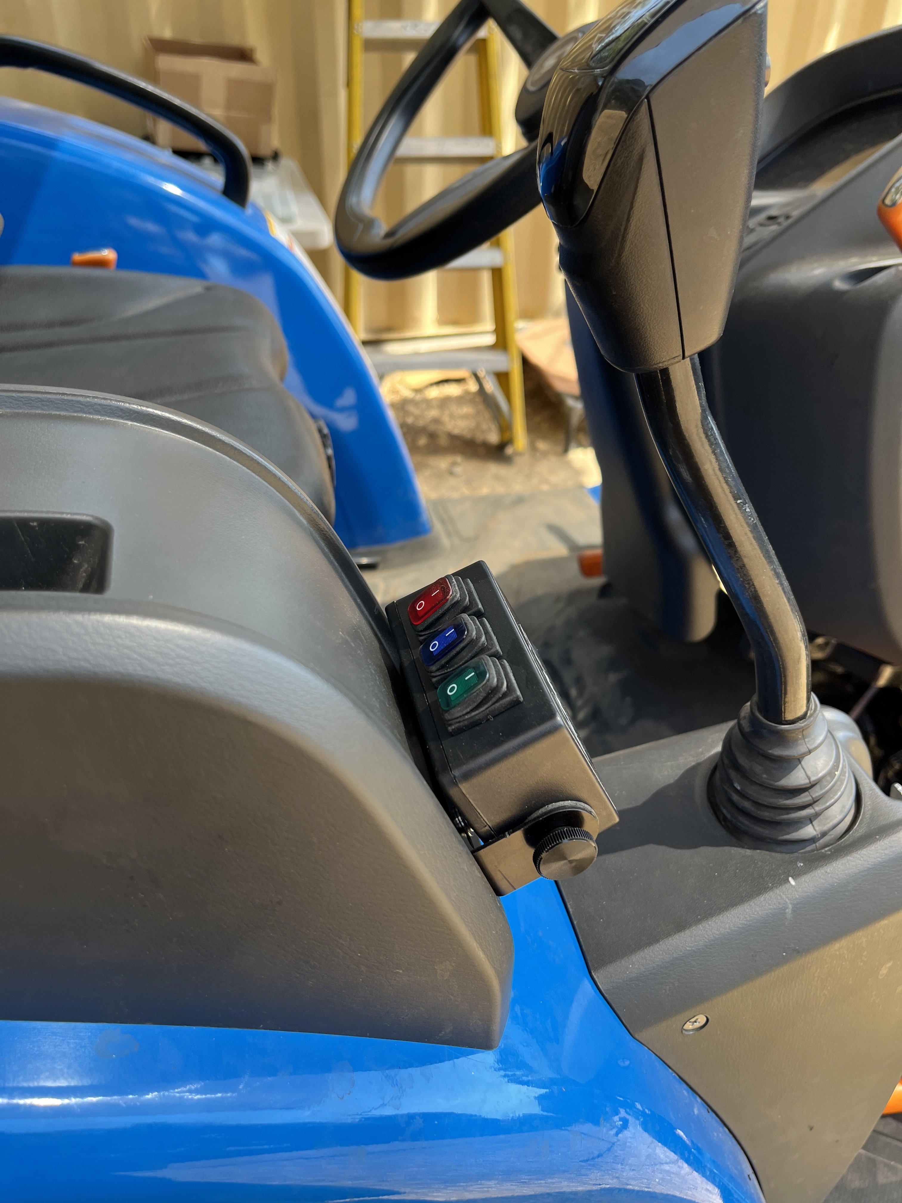

Mounting of the switch to control which valve is activated

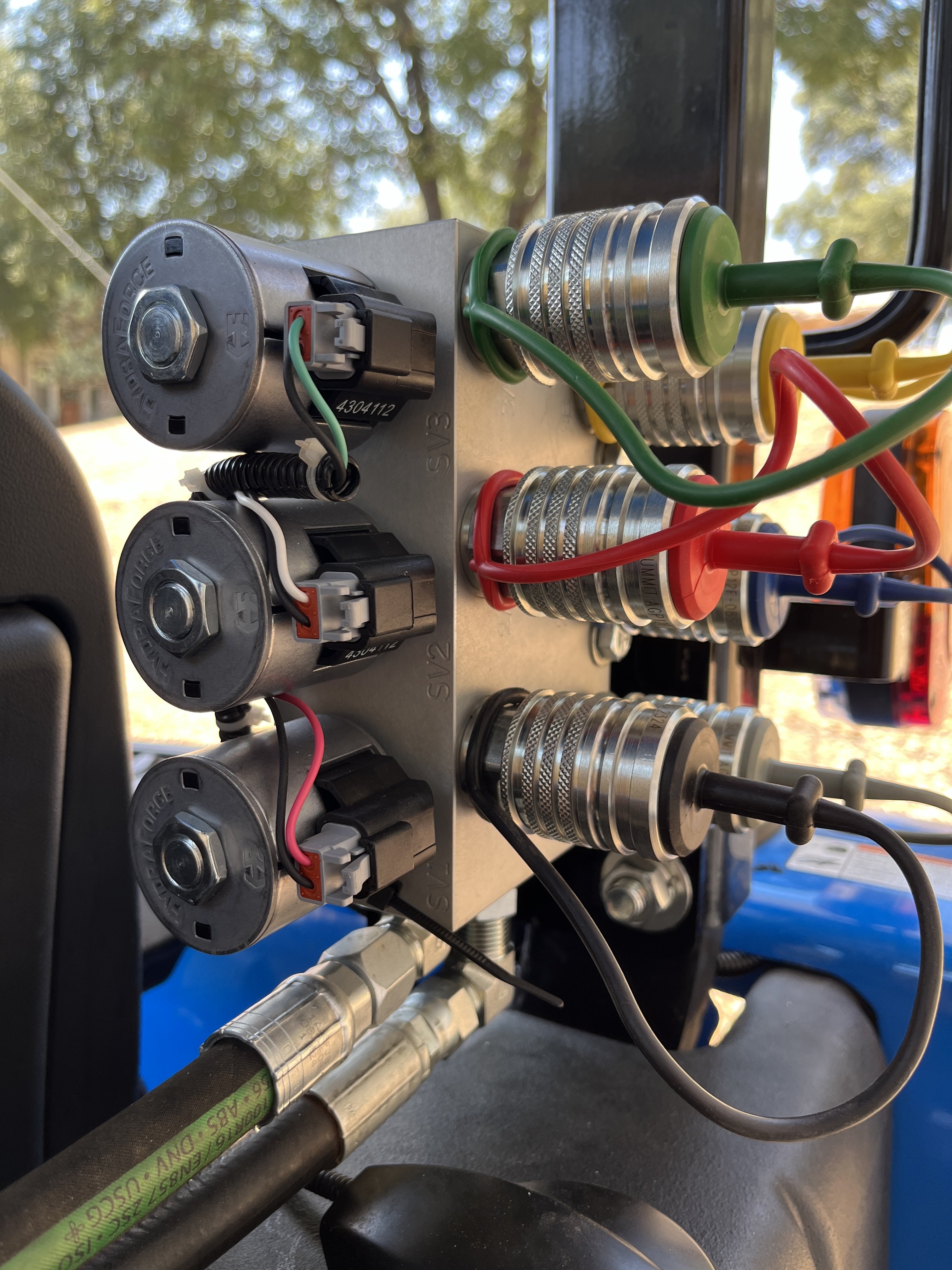

Out of the way but easily activated with my thumb. Shows the power hook-up and ground are functioning.

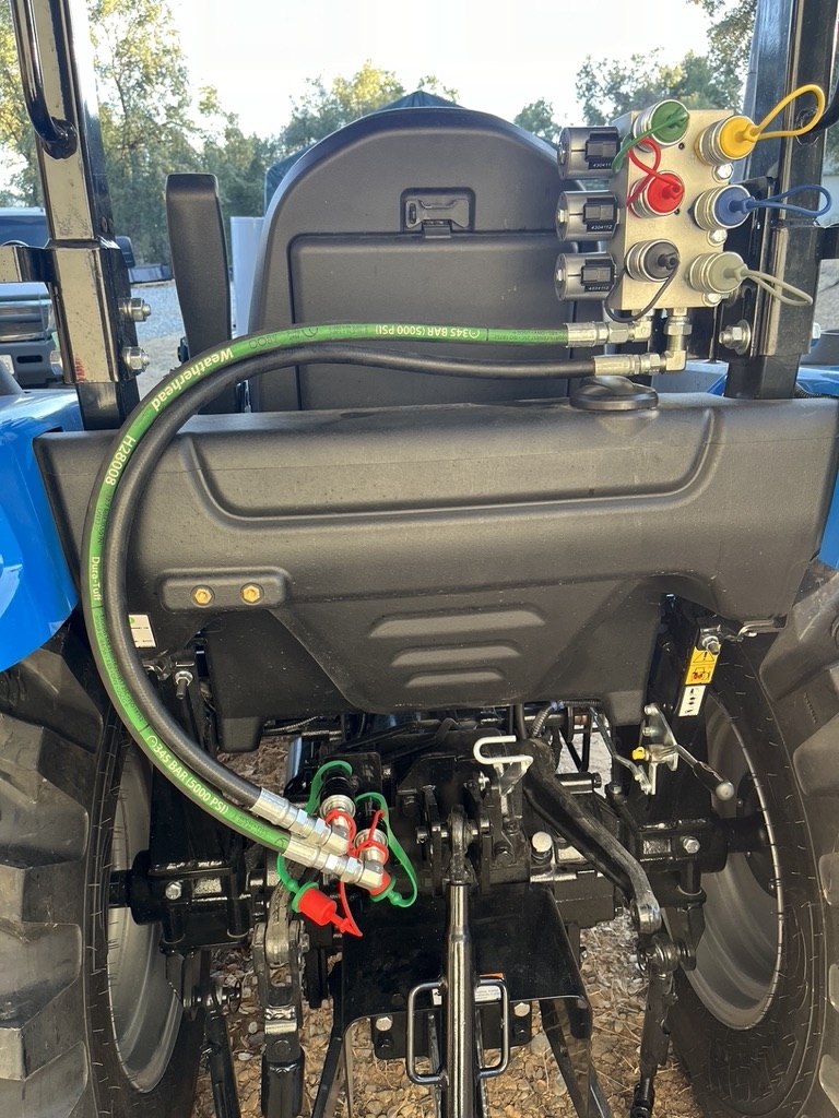

Making one hydraulic port into three. Hooking power up to the ignition switch.

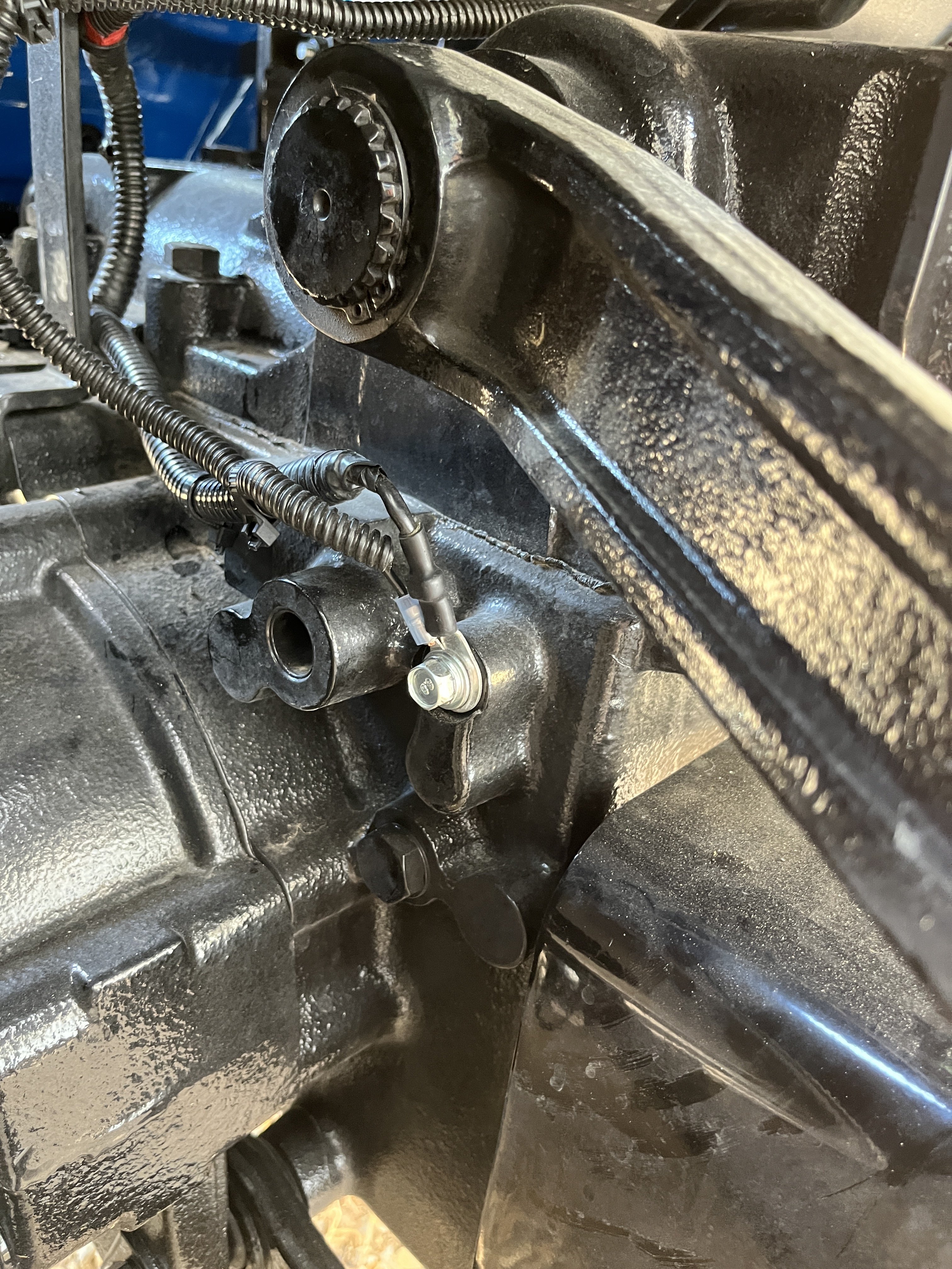

Ground at the back of the tractor. Not really a good photo, but showing the routing of the power cable.
