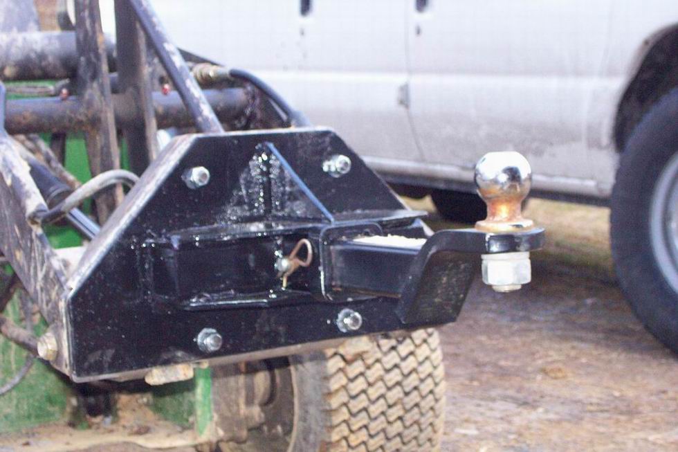

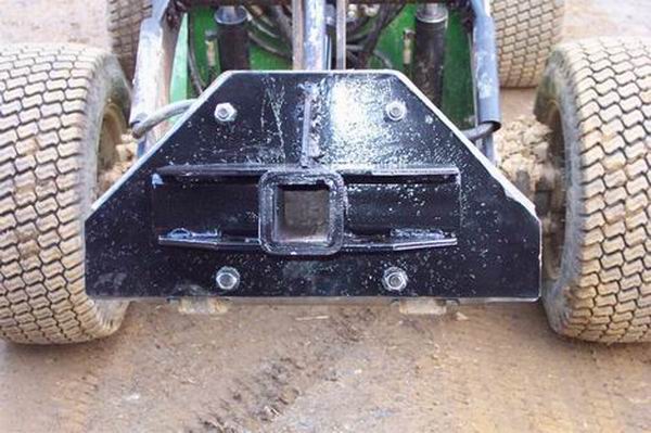

Didn't heat the tine. Put the small loop in vise inserted pipe through the spring loop and twisted straight.. Attachment is front view of receiver hitch welded to 1/4" plate. Second post is the back of quick attach plate..

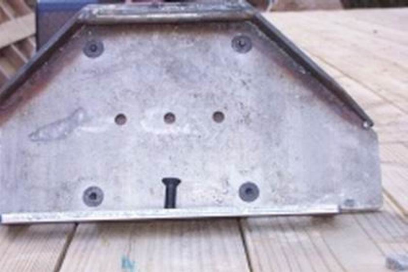

This is the rear of the quick attach plate the hitch is bolted to. The bolt shown center bottom is the type of cap screw you must use.

Another view of the hitch.

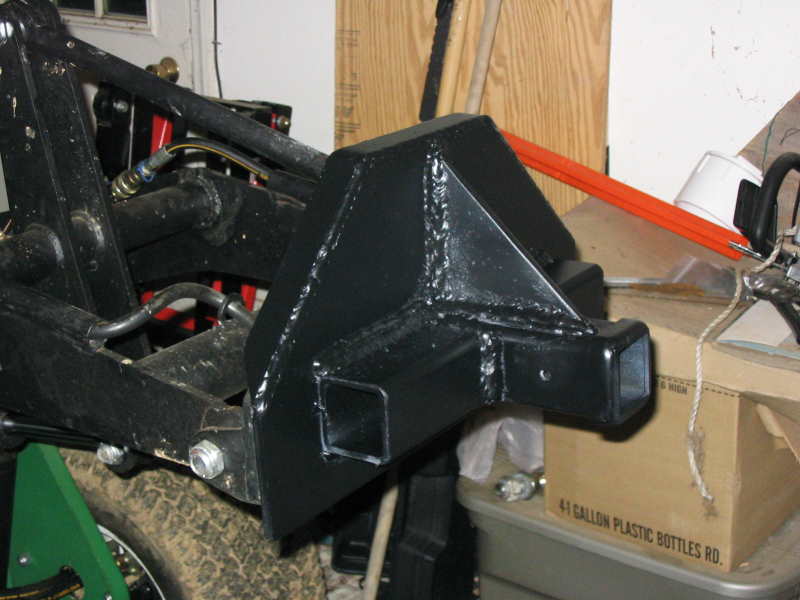

</font><font color="blue" class="small">( I'll post a front view. I had an old class III hitch for a Bronco. I cut the wings away that would have bolted to the frame of the Bronco. Cut a 1/4" plate close to the shape of the quick attach plate and welded it to that plate. I had a quick attach plate that I had purchased it came with holes drilled in it. I counter sunk the existing holes and I bolt the 1/4" plate to the quick attach. You must counter sink because the back of the quick attach plate must be flat.. My next attachment to be bolted to this quick attach plate will be some kind of ripper. These attachments wouldn't be used a lot and I think I can handle the time it takes to mount them on the quick attach plate when I want to use one of them..

Yes I purchased the quick attach plate from PT and it came with seven pre drilled holes.. I had to countersink the holes.
I used the trencher the other day and noticed the trencher is bolted to the quick attach plate. The holes in the trencher plate are countersunk. You could most likely order a plate for the trencher and it should come with the countersinking already completed..

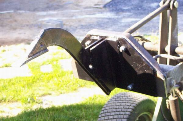

Looks tuff. You could weld up a nice ripper shank to go in the receiver that could rip coming or going.

Fabricated a ripper. Works good loosening my clay soil so I can dig easily with the bucket..
