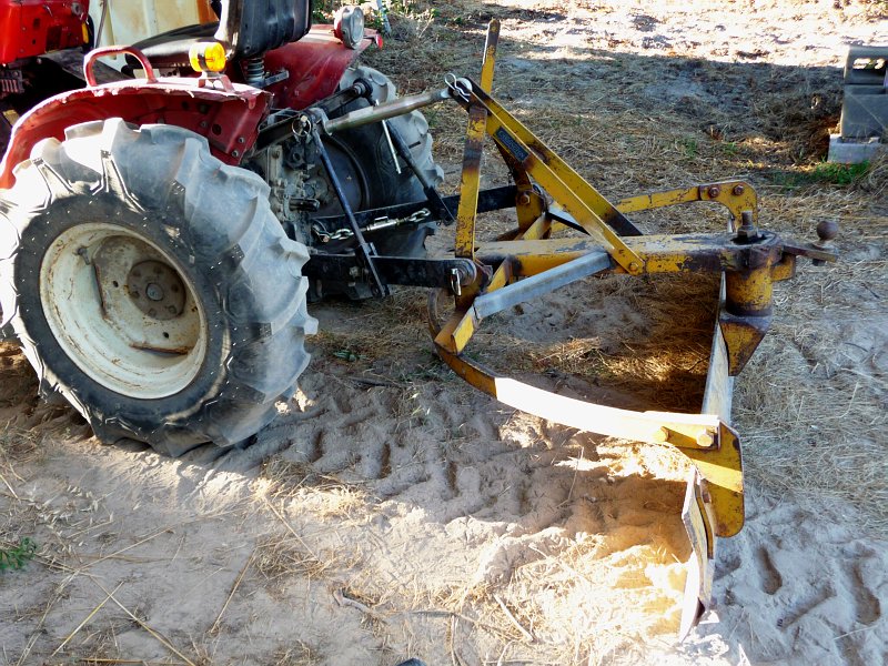

Wow! Does my YM186D have those light 1510 arms, or stronger ones? I assumed this could lift and carry anything it could get off the ground. I already used the 4 ft Howse mower. It works fine. I was hoping to share the implements I have for the YM240: RS1400 tiller, 5 ft Howse box blade, 4 ft disc, maybe even try the 6 ft disc. (But I won't install the 3pt backhoe!)
Maybe I should stick to just the 6 ft ditching/grading/snow blade ('Carrington Terracer') that came with the YM186D.
