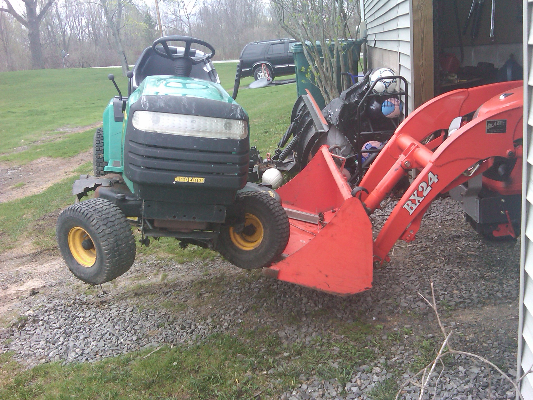

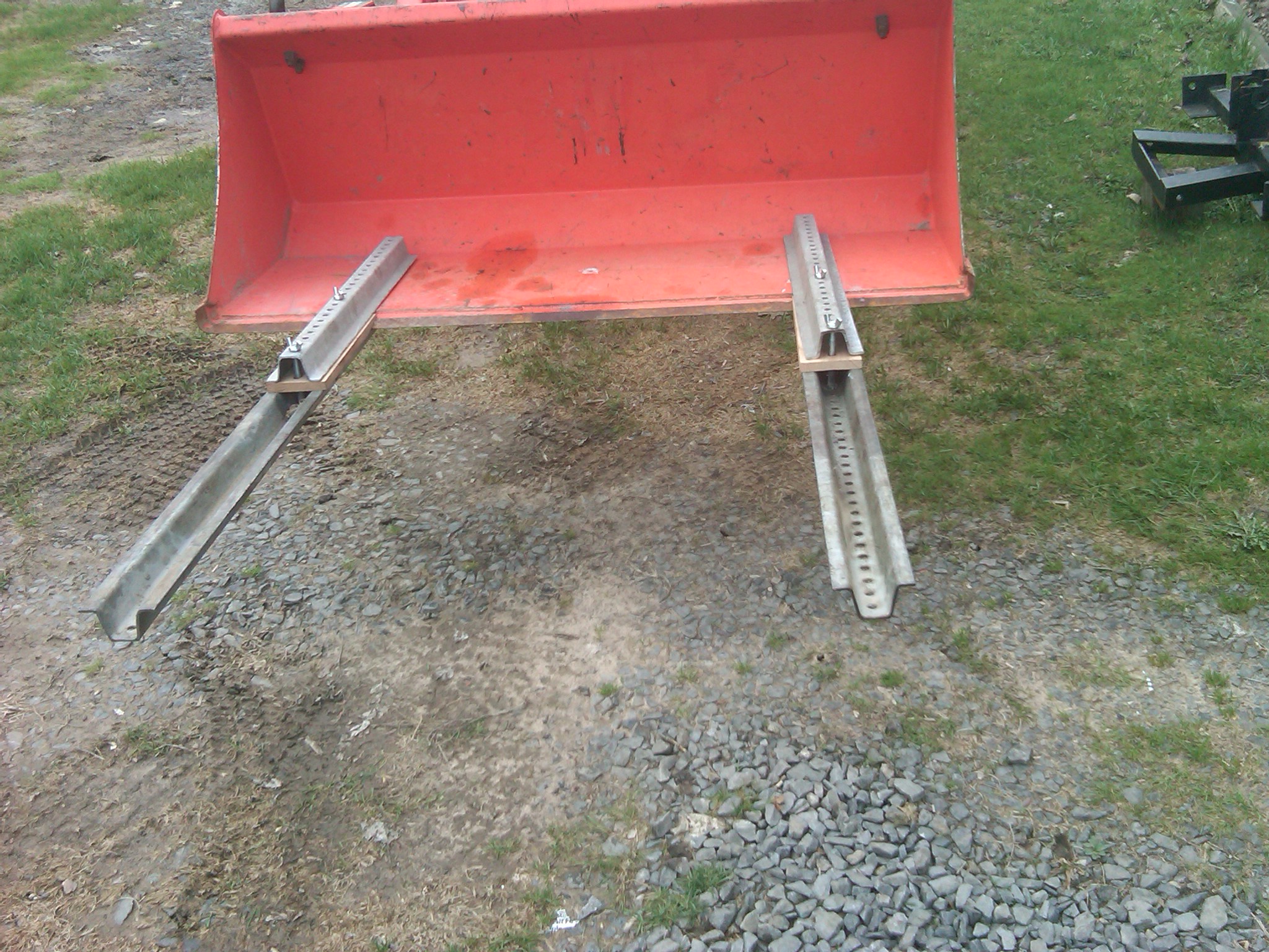

you need another one under bucket. use bolts as clamping action so it will hold. I tried it your way with wood before and It works, but soon breaks when I try to do more. Let me post a pic of mine made of metal scrap sign posts later today for ya.
better late posting pics then never. As you can see I can lift a cheapo tractor with bucket with no problems.

That's a great idea and they use the same steel post they use around here for road signs. I wonder if anyone will notice if I move the road sign to a tree (just kidding). ;-)
