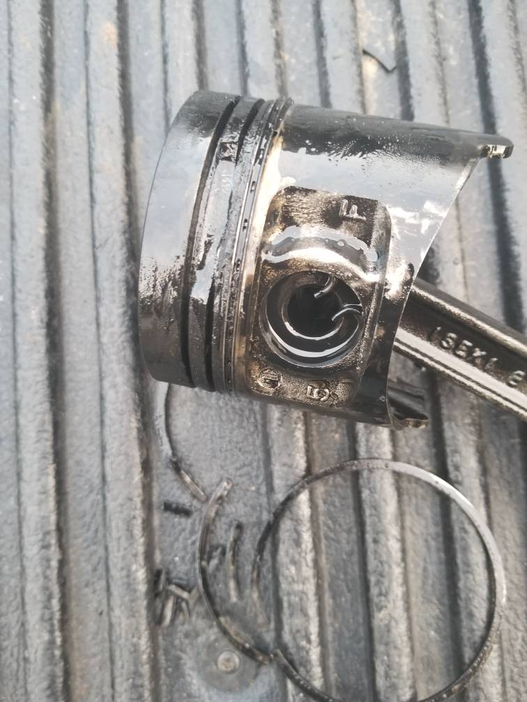

Piston is out. Broken second ring and middle lan. Which is quite unusual, pre-detnation usually effects the top ring and lan.. top ring and oil ring were both free and fine. No chunks missing or even big scratches to the piston beats all I ever seen. Assembly error perhaps? Anyway I have one bad push rod too so all parts ordered. Will clean this weekend and wait reassembly. View attachment 631383
Detonation pressure on the top ring broke the ring land below it. The chunk of ring land took out the second ring. Pretty typical for the circumstances.

If you look at the piston you will see that the land is cracked downwards with the narrow part at the top and the wider part at the bottom. This is a clear indicator of detonation as Rick B has stated. What are you plans to address the scratches in the bore? The engine is a parent block, and it appears that they do not offer an oversized piston. This is a sucky situation for you. In Louisiana there should be no need for any type of starting aid ever required for a healthy diesel outside of glow plugs.

That's a real good photo. Thanks for pulling the piston & posting that. I also agree that RickB nailed the cause. The upper part of a piston has a smaller diameter than the lower part, so it is likely that the first thing the detonation ether/gasoline expanding gas front sees is the compression ring which then gets forced down against the land below it.
I believe I'm with you on reassembly as is. I've seen worse scratches in engines that were running fine when disassembled.
Only a couple or more questions: How did you get the piston so clean? And what bent the push rod? Is there any wear step in the cylinder at the top of the ring travel? And do you plan to do a light hone or no?

The piston is exactly as it was removed I didn't clean it in any way. Actually the whole engine is this clean I really didn't even get that dreaded diesel oil stained in my hands lol. Guess low hours and good maint is to thank..
As for the push rod it isn't bent the lower end is a male "ball" socket but the top is a female "bell" socket. That bell had come un-pressed from the push rod tube and it separated but it couldn't come apart because it was held squished together... Ever since new I heard a faint noise in the valvetrain but it always ran fine. So when I pulled the rocker rail one of my push rods fell apart and then I know what the sound was lol.
And zero ring grove not even any carbon build up at the top, the piston pushed right out.
Over the years I've built hundreds of small engines mainly ATV and motorcycle engines. Along with quite a few autos but very few diesels I'm just not a fan of diesel grease lol. Anyway I have learned if the cylinder looks good its best not hone it just leave it be. I well understand honing is a hot debated topic and I understand the purpose of what honing does but it also removes material and IMO the oil ring is designed to wipe the oil off anyway. The only time honing is needed is after a bore to rid the screw process of the bore machine but in a perfect world a smooth cylinder is best for a oil ring to work... And I don't buy the wear pattern idea that new rings won't seal because the old rings had a wear pattern relationship with the cylinder I've built enough engines (not honing) to know this isn't true.
