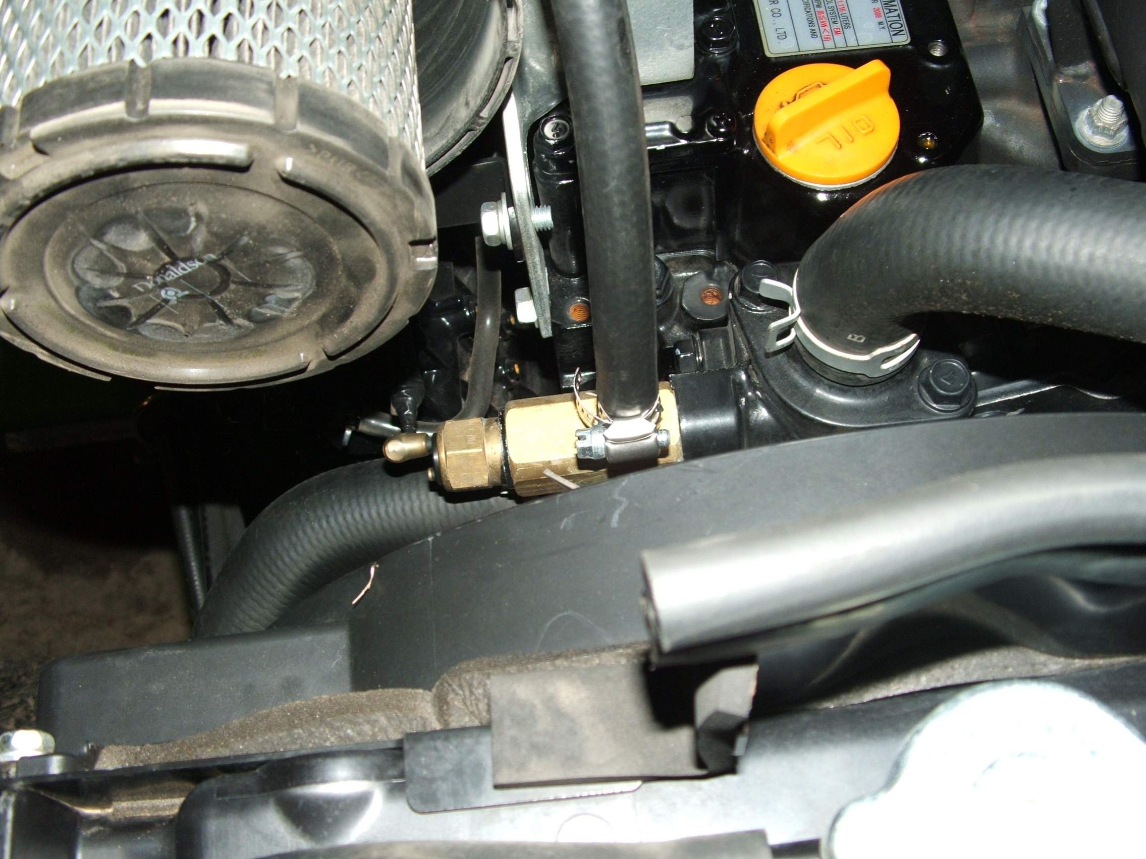

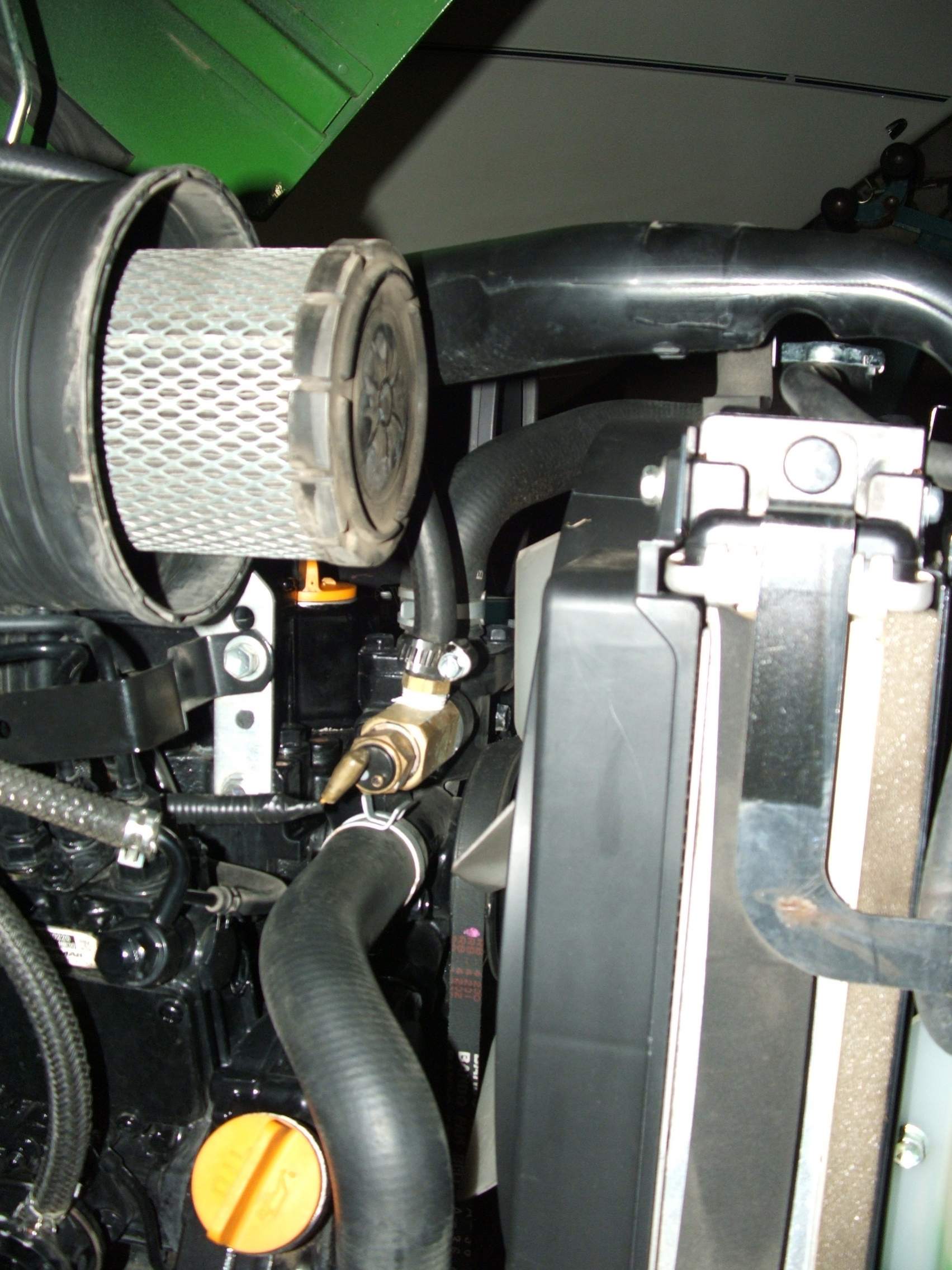

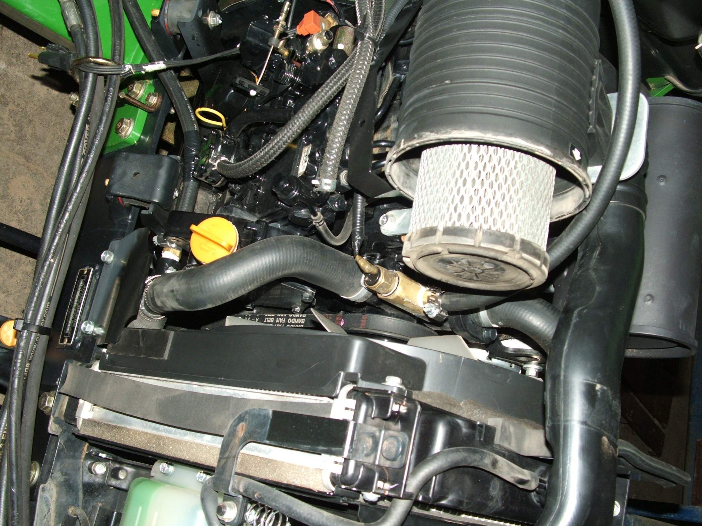

I have a 2520 that I will adding a heater soon. I have question about the supply line hookup.
What side of the thermostat housing did you tap into? It looks like you tapped into the drivers side near the alternator.
I bought the Curtis adapter and their manual shows it hooked up on the opposite side. I don't know if it makes any difference but the drivers side might be the suction side of the water pump. Just a thought for you to consider. Can you post a picture of your hookup at the thermostat?
MSTURBO
Here's a few pics of a 2305. Jodale-perry cabs gives an adaptor for the sending unit, you can see in the pics.
