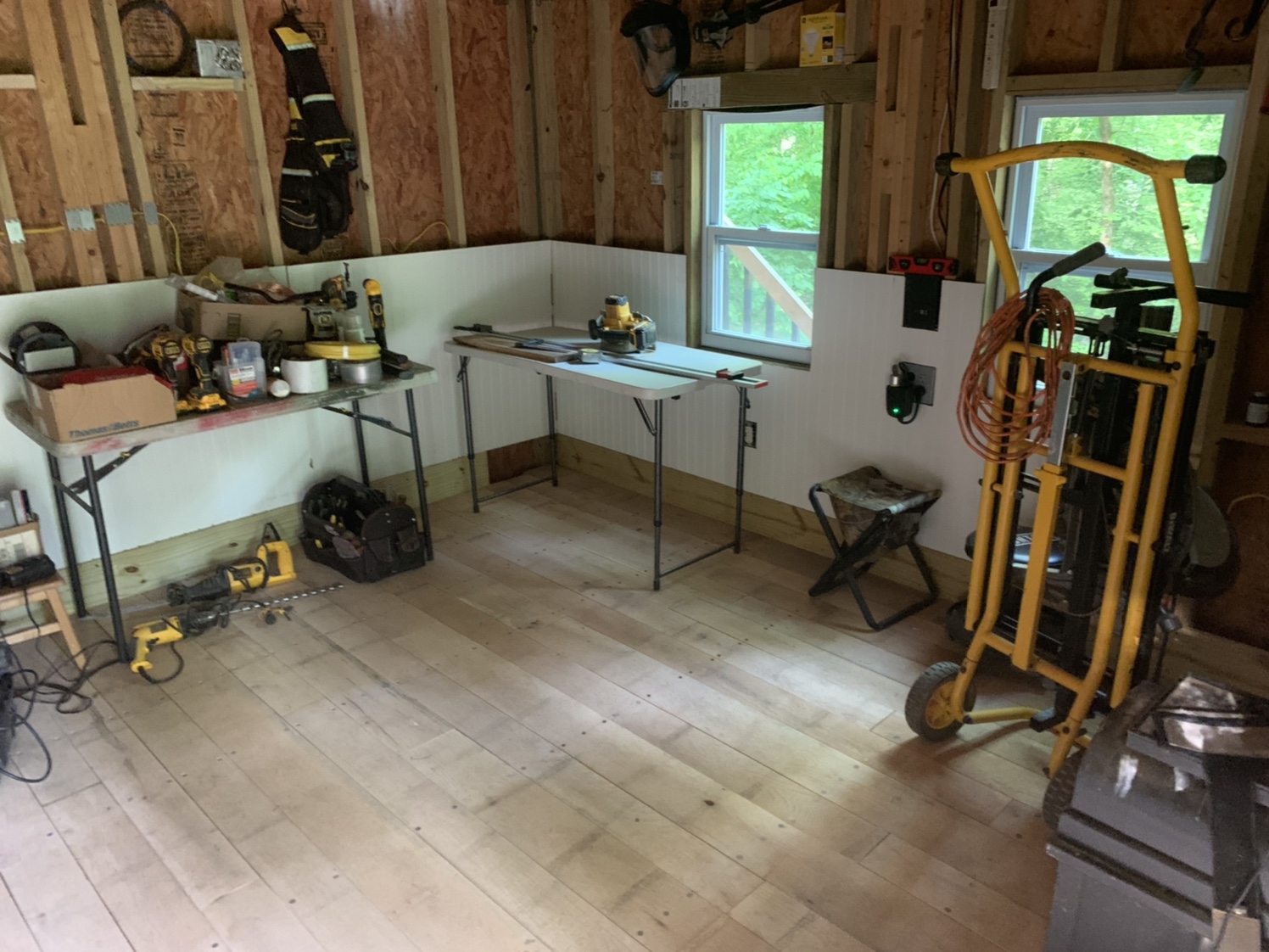

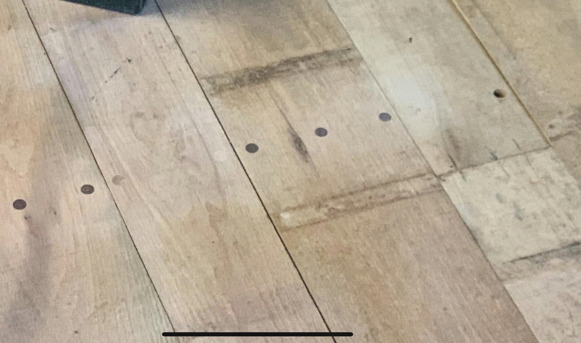

Uh-oh, what's that hole in the floor? :D

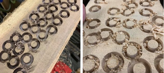

Which one? There are hundreds of half inch forstner bit drilled holes on the floor. The floor is not tongue and grooved. Just joined on the sides and bisketed at the end grain sides. I did it this way on purpose. In Each hole and under a top grain plug (walnut and red oak) there are 3 inch torx screws driven into the subfloor. With 5/4 air dried red and some white oak, the floor is rock solid. I haven’t plugged all the holes yet. I guess that’s what your seeing. I just dry fitted bead board on the lower part of the walls. Once I cut all of them, I’ll remove and install a vapor barrier and finish the walls. Once all that and other things are done, the floor will be finalized. IMG_5226.JPG
   / Loud bang noise on start and stop of New Bx2380 #16
Bigtiller was just joking about another thread called "What the heck is making these holes?". It did make me chuckle. :D
Nice floor too. Did you say you plan to sand it, or are you leaving it rustic?

haha - yeah - I know.. I looked closer at the pic and indeed one of the holes plugs.pngisn't plugged. BTW the wife's only task is to install the plugs. lol
