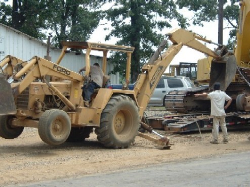

It took about 4 hours for them take care of me. I didn't have an apointment, I just showed up and two guys went to work, with one doing most of it. He just kept at it until he got it done. They used two old taps to retap it, and decided to go to town and buy a brand new one to make sure it was right.
This is that same 755B Ford they use for everything. They said the one track with pads weighed around 2,500lbs.
