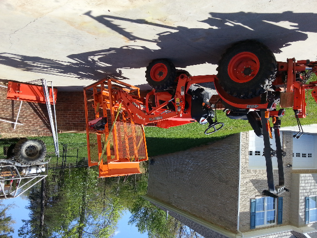

The LA364 loader on my B2920 has a lift capacity of 950 lb or so. I had to lift an 850 lb generator on pallet today, but of course the pallet probably weighs 50 lbs (it's a beefy one) and my clamp on forks are 100 lb, and I was so excited about the project I forgot to take that extra weight into account when planning things (I figured I had 100 lb to spare, well duh).
I was able to lift the pallet up off my trailer about an inch and curl the bucket to lift and back out, but about halfway along my route to the garage the power steering got pretty weak. Everything was fine again after I deposited the generator in my garage, but I am curious about the loss of power steering. Can anyone with more expertise on the hydraulics system on the B series educate me on what exactly happened?

While I've no idea on how the weight might have affected the PS, the calculations you made were probably lighter than the machine experienced just because the weight was even farther out on the forks, and not in the bucket itself. You were more than maxed out.

The only reason that I can think of is that if using the loader to max, you were close to stall, and the rpm of the engine decreased and therefore the volume of the steering pump decreased.

The B2920 has separate hydrostatic/steering and hydraulic pumps so unless you were somehow stalling the engine, your steering shouldn't have been affected at all. Have you checked the state and level of your UDT hydraulic fluid?
Furthermore, the LA364 is rated at 950 lbs at the pivot pin - with clamp on forks moving the load out and the length of a pallet, I'd think your effective lifting capacity would be closer to 600 lbs. I can't imagine any way you'd be able to lift a 900lb pallet + 100lb clamp on forks with that loader/tractor combination.

Did you have any? If so, how much did it weigh? You need a fair amount of weight on the 3PH behind the rear axle to transfer some weight off of the front axle.
With clamp-on forks the weight is very far forward as mention, I thing your lucky to have lifted it at all!

Yes, I had my box blade on the 3-point, which is about 475 lbs. I figured I could have added more weight on that if I detected the need, but did not get the sense it was required (one time long ago I lifted a bucket of gravel with no rear ballast and still remember what that felt like, but this was nothing like that).
The generator actually weighs 902 lbs according to better specs I found, and I know the forks are 100 lbs, plus they put the load out in front. Then the pallet. So I was definitely way past the 850 I had in my head!
