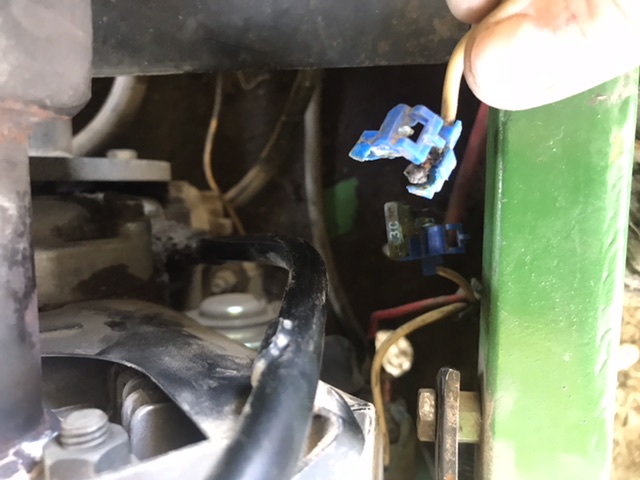

Found the culprit...
   / Loss of all power...? #12
That'll do it. Cheap fix, good.
   / Loss of all power...? #15
I have had several wires break due to the vibrations, always at a connector. I like to tape any connections I make - acts as a strain relief.
