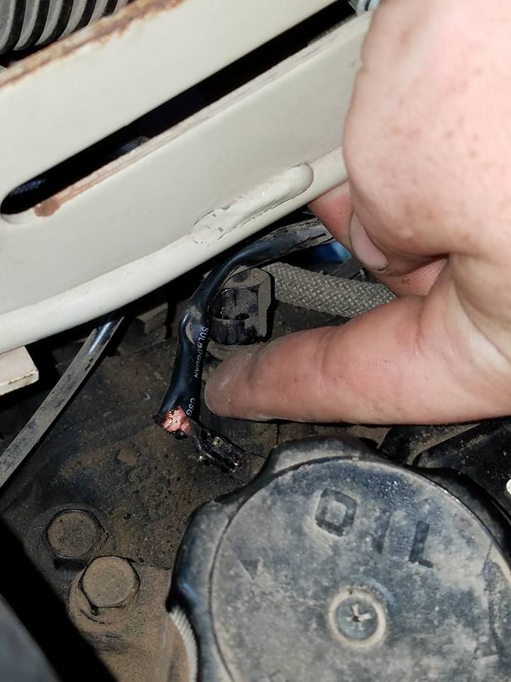

This is a follow up post from the one before about losing the filter screen down into the tank. We still can't get it out, but we are certain that is not the problem.

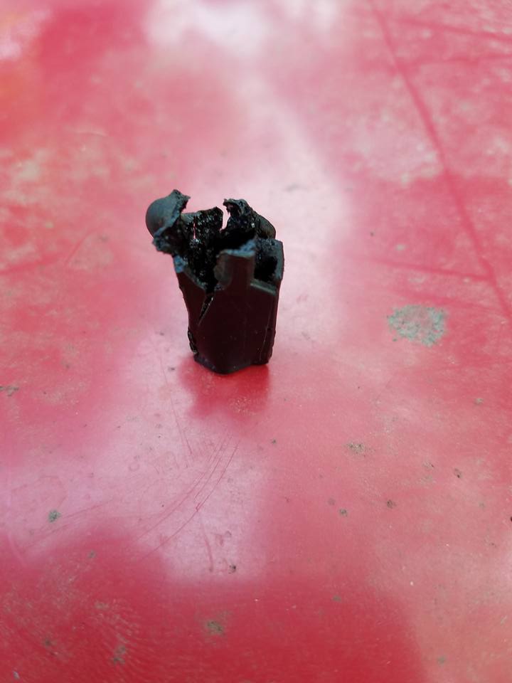

Zack (person who is helping with this) came out this morning to trouble shoot the problem. Some sort of wire with connector started smoking and melted the connector. See pics below.

What is the connector bolted to. Looks like a ground. Were you cranking the tractor alot.
   / Losing RPM
He said it was a ground. He was trying to start it. Sometimes it won't engage when started, you have to move into neutral several times.

Sounds like Zack ran the starter too long and melted the ground. Do as said above and fix the ground and try again. Let the starter rest a little between tries to cool down
