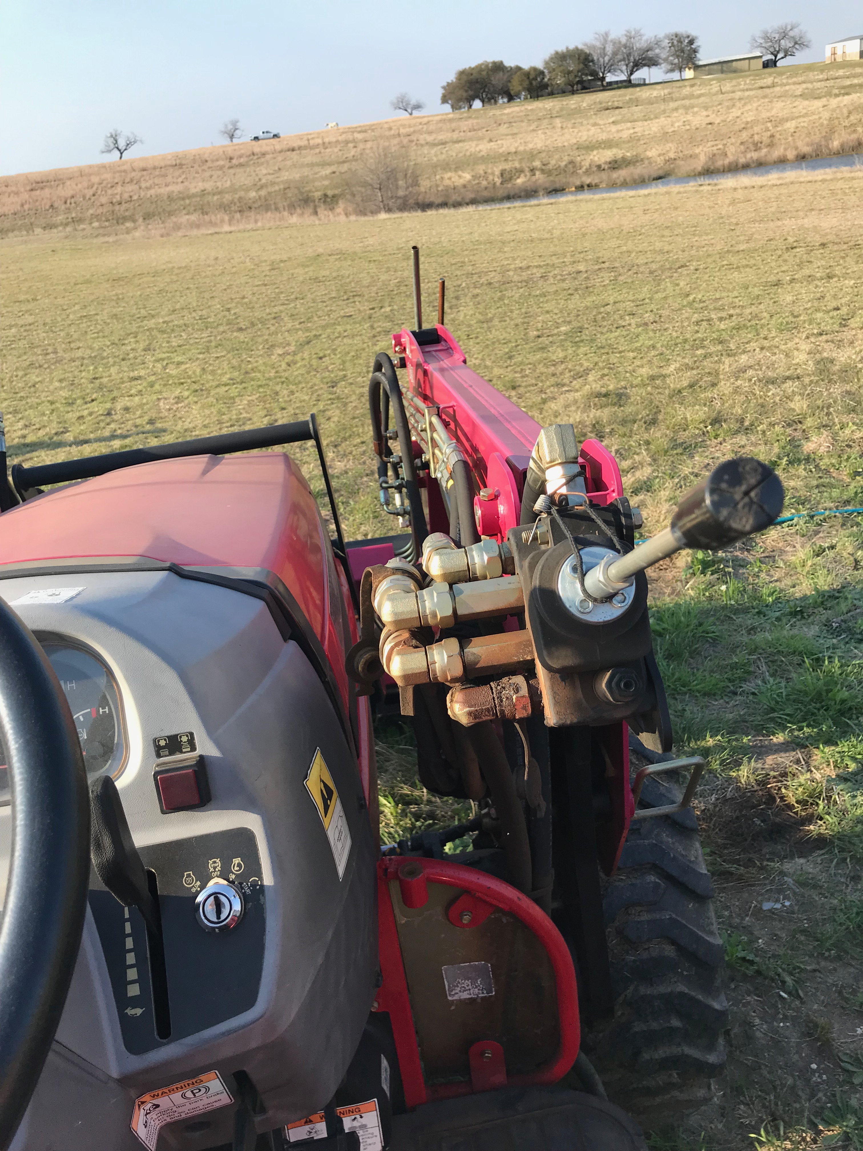

Hey guys - I have a Mahindra 4010 and the loader joystick developed slack after about 120 hours, and I'm not sure if it is a valve issue or if there is adjustment possible - someone else understands it better than I do. I have to use a bungee cord or it will very slowly lift the loader. See pic. What can I do?

I don’t know that valve but if it was mine I’d pull those 4 Allen heads- from there the rubber boot should come off too. I’m sure it’s a simple adjustment below that.
/ Loose joystick #3
Actually this sounds like the nut/bolt that holds the spring at the bottom of the spool may have worked loose...it happens...
If the nut/bolt has worked loose just the weight of the joystick is enough to move the spool and raise the bucket if the spring that holds the spool to center is not doing so...
I would pull the cap off the bottom of the spool and check the nut...

FWIW...If the spool is moving (the OP said the bucket was rising on it's own) then it is not staying at center...just loose linkage would not cause the spool to move...

It's loose enough that the lever slightly hangs down, and the weight is enough to cause the loader to rise very slowly. With the bungee cord, I can keep it centered and the loader won't move. I'll check for a loose nut and post what I find.

Pulled the cover off the spool - did not see any nut.
Pulled the cover plate and boot off - tightened all the linkages.
Seemed to make the handle slightly less "heavy". Still requires the bungee to keep it held fully upward. Can't figure it out otherwise. Tightened all hydraulic conections and even opened the fill cap to bleed out any air.
Other thoughts?

Tony83 I had the same issue about 6 months ago with my mahindra 4010 bungee cord and all to keep the valve from slowly lifting my loader arms unless I had about 1000 lbs hanging off the front. It ended up being the spring centering unit on the end of the valve assembly needing tightened up. I will try and take the cover off mine tomorrow and snap a pic of the adjustment I had to make. I believe it took a large flat head screw driver if I am not mistaken after taking the plastic cover off with 2 Allen head screws. Hope this helps because I understand your frustration with it.
/ Loose joystick #12
I noticed this was posted about 2 months ago so maybe the issue has been resolved but here are the pics of what the issue was for my loader valve. The cap can be taken off with a 4mm allen wrench. And then the outer ring in the cap with slots needs to be tightened up.

We moved about a year ago so I’m just looking at this. It was the loose slotted piece inside the back cap to the spool that Whfabrication showed. Thanks for the tip, I would never have realized that.
