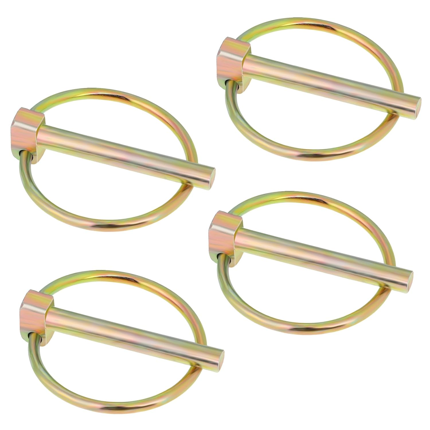

Use a #8 bolt with a wide nut drill small hole and use
a clip similar to this:
willy
