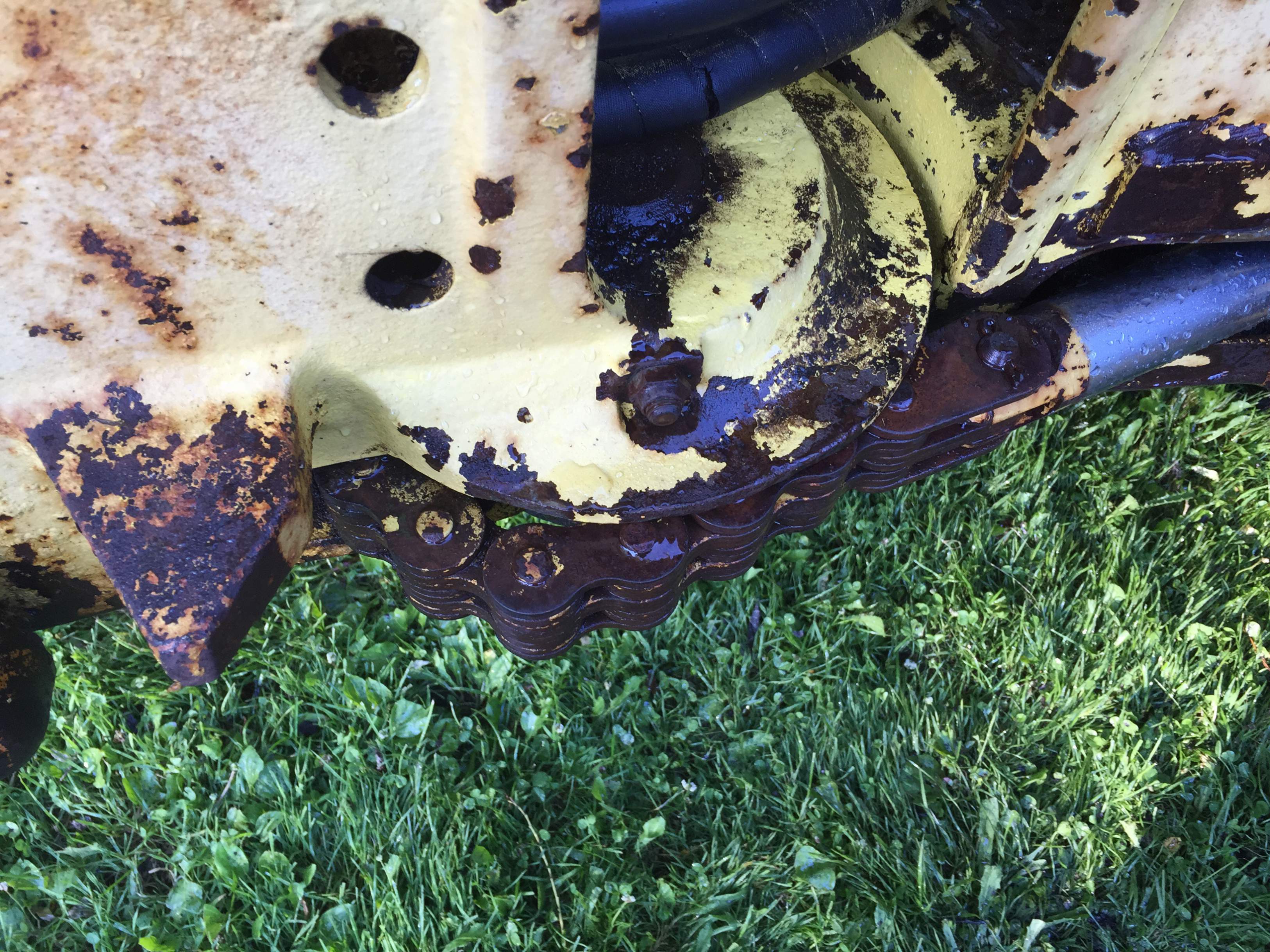

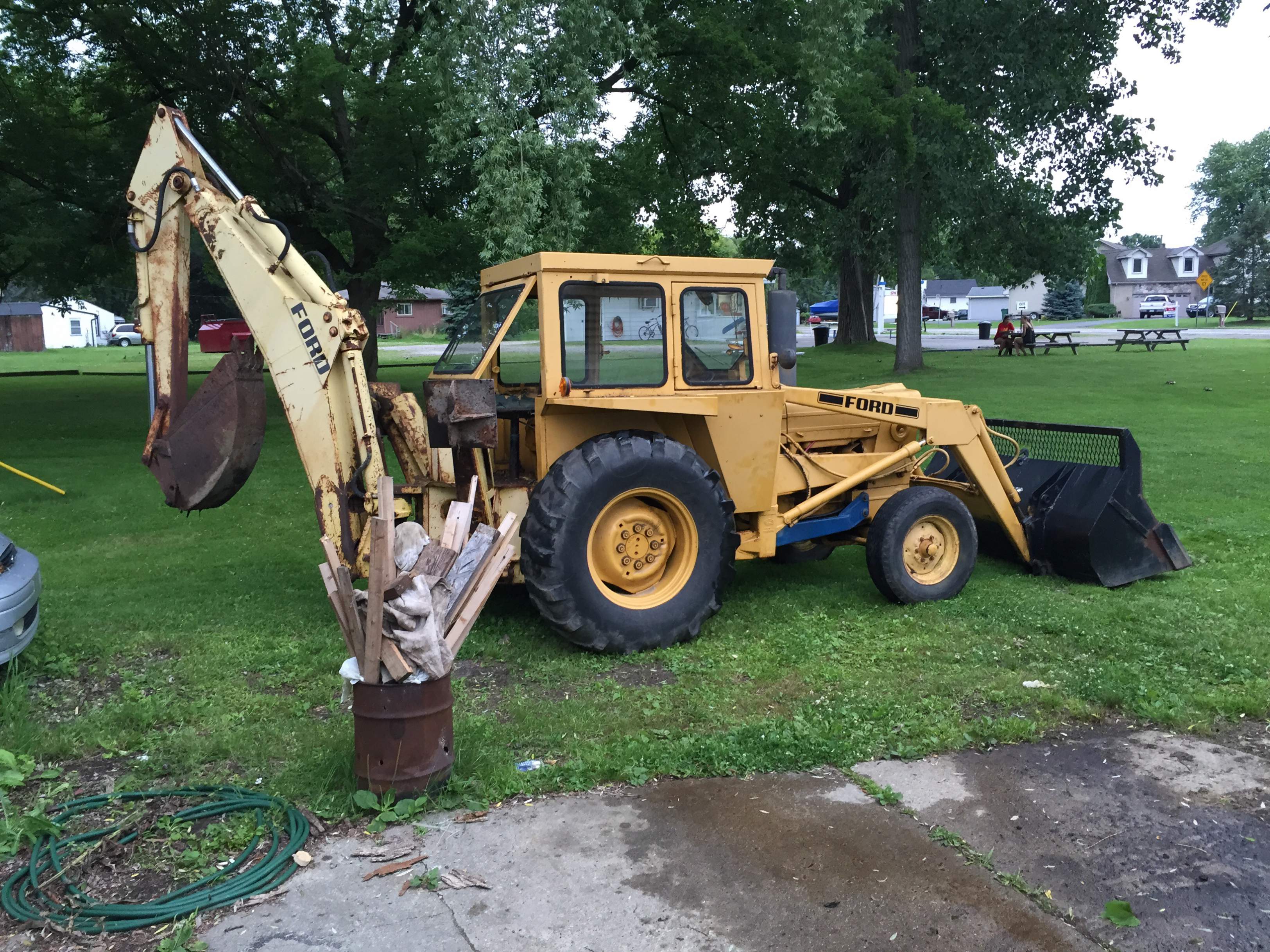

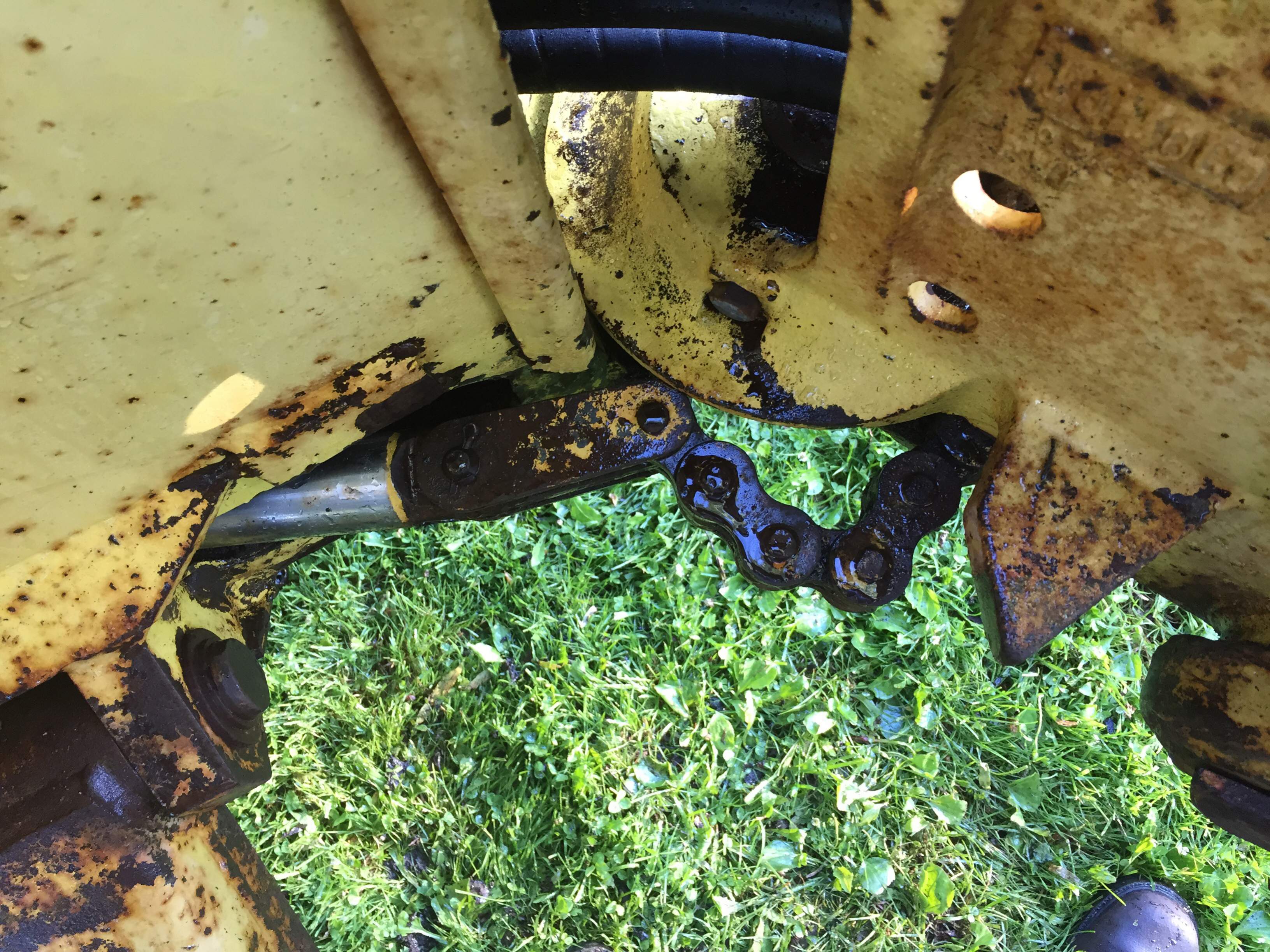

Hi all, after a lot of work I finally got the BH mounted on the new tractor. It's a Ford 4400 with a 753 (13') BH mounted to it. I bought the BH a couple years ago. My other tractor died so this is the first time I've had a chance to try it all out. The levers are stiff, but they're starting to loosen up. My big problem is the loose swing chain. I know the swing cylinders are single acting and only pull. The boom will swing left/right. With the boom in the center, If I stop at the 45* position, the boom will coast all the way to the 90* position. The BH hasn't seen hardly any work at all. It was sitting under a pavilion for a long time before I got it. Any ideas as to what I should be going after.

Unless the cylinders are completely wore out it has to be the swing chain and there are no adjustments for it I could see.
/ Loose Ford backhoe swing chain #4
It's not the swing chain. It works or it don't there is no in-between The Cylinders are the issue been running a 755 15' hoe for 20 years and a 753 like your's for 22 years the link that attaches to the Cylinders break most but trust me its in the Cylinders
