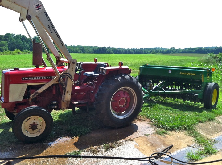

Well the dealer called this afternoon and it's already here. He said a truck was coming from VA so they decided take advantage of some empty space ;-) I told him to get the Modulation Control coming so it can be installed. She hasn't made a decision on the radio yet. I'm going to call Crutchfield and see if they have ever dealt with JD cab installs.
   / Looks like the farm is getting it's first JD tractor a 5065M, a few questions :-)
#18
Well the Modulation Control is on the way along with 2 sets of rear wheel weights, a front weight bracket and 4 suitcase weights. Looks like the only tractor they'e getting on the trade is the Farmall Super H. Wife just couldn't turn lose of the IH 574, too much sentimental value and they really weren't offering enough for it IMO. She got choked up talking about it today. Before her Dad passed he said it was his favorite tractor. Gotta get her a radio figured out, they $460 for an AM/FM radio no CD from JD, that's just nuts. The Super H is actually part of the reason her Dad is no longer with us but that's another story, wife has no attachment to it.
