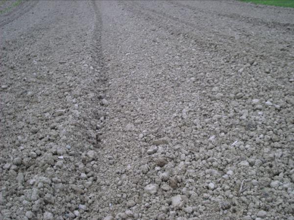

here's some pics..

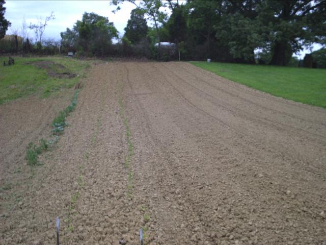

another

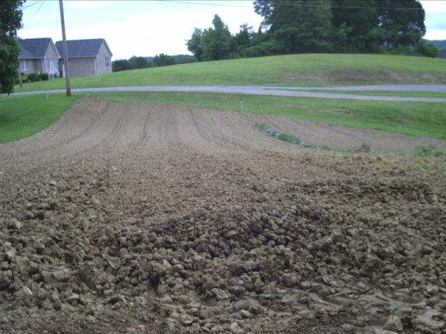

one more..

Do you have any idea how much those tightly packed dirt clods would be worth to the Palestinians?

Hi nomike:
hey I see you have lots of gray clay... I have the brown clay more sticky than anything. try to shovel it and it is like wet concrete... anyhow you can add gypsum, the cheapest and easiest way is to get in contact with a drywall contractor and see if you can get scrap drywall board off of them... many times you can get a pick up truck load or two dropped off by them if they are working near by. ( have had 2 loads put into my garden which is about 1/2 size of yours. ) though I helped hang the house that the scrap came out of because my brother owns the drywall company. he gets calls every now and again from people looking for it too. He gets paid to remove the excess/scrap and has to haul it away and pay to dump it some times so a free dump sight is useful to them... you may even offer to remove the scrap for them and charge them small fee... (usually 1.5 to 3 cents per sq ft of hung dry wall.) average size house would have enough scrap to help you out.
I tilled mine in after it sat for about 3 days in damp but not rainy weather, it breaks up better if it is dry I found out... anyhow I tilled it with about 4 passes in LL2 on my and tiller.
the pic attached you can see the far right side has white spots in the dirt is the tilled in gypsum/drywall board, (ya, the dirt looks black but is actually 90% clay it's just wet!) the taters are growing nice but so poor nothing else even the beans won't grow...

It just looks to me like there is no top soil,or much of it anyways in your spot.You got to have some organic black stuff in there.I'd plant some stuff in it and see what grows,the ground don't got to be fine like flour to grow stuff in,but it does have to have something besides clay in it. What ,I wonder was that ground used for before?If it was dozed,maybe all the top soil was removed,or a good bit of it.Some areas in every location don't have much top soil to begin with.If you could plant a cover crop and lime and fertilizer before you did this year,like red clover or winter rye this fall, a couple of inches of cow or horse manure would also help a lot,than early as you can next spring till it all in. You might have to rotate your garden this way,untill you get some top soil built up. I can't believe all the gardens around your area are that way,if the ground in them look like yours,I don't see how anybody grows anything.Unless you got good rich river bottom land,you got to work on your garden soil a little,or a lot to get it to be good rich soil. RICHARD GAUTHIER
