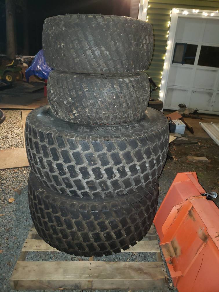

Yup, picked up a set of used wheels and tires today (kinda lucked out finding a decent set that was affordable), had them lined up to buy before I even bought the tractor 20201222_183104.jpeg

Yup, picked up a set of used wheels and tires today (kinda lucked out finding a decent set that was affordable), had them lined up to buy before I even bought the tractor View attachment 680750
Nice find;your going to love your new ride.My BIL has turfs on his L3300 and they work pretty well in everything but deep mud.

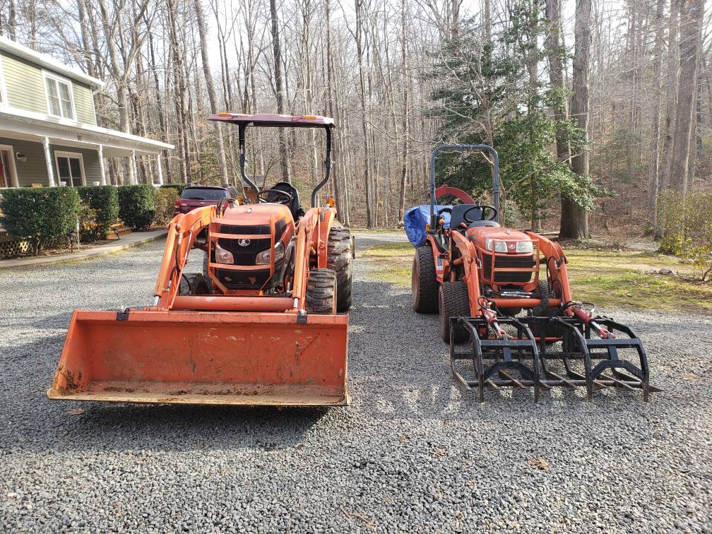

Finally got a chance to use the new tractor this morning, I only have a 60in box blade from my B series so I put that on and figured I'd grade the hill in front of my house. With the B it was a struggle to pull the gravel up the hill without losing traction and having to feather the box to drop weight, the L just kept chugging along with a full box of damp millings.
I know its only a 60in wide and I need to get a 72 to cover my tracks but I was still presently surprised how well it did!
I do miss the top and tilt, already looking into adding rear remotes, not sure I want to spend the $2100 for a factory set, will probably end up making up my own for it.
I think I'll switch the Pat's from the B to the L and put the old HF quick hitch back on the B.
Got a quick pic of the B and L side by side while I was at it.20201223_105757.jpeg
