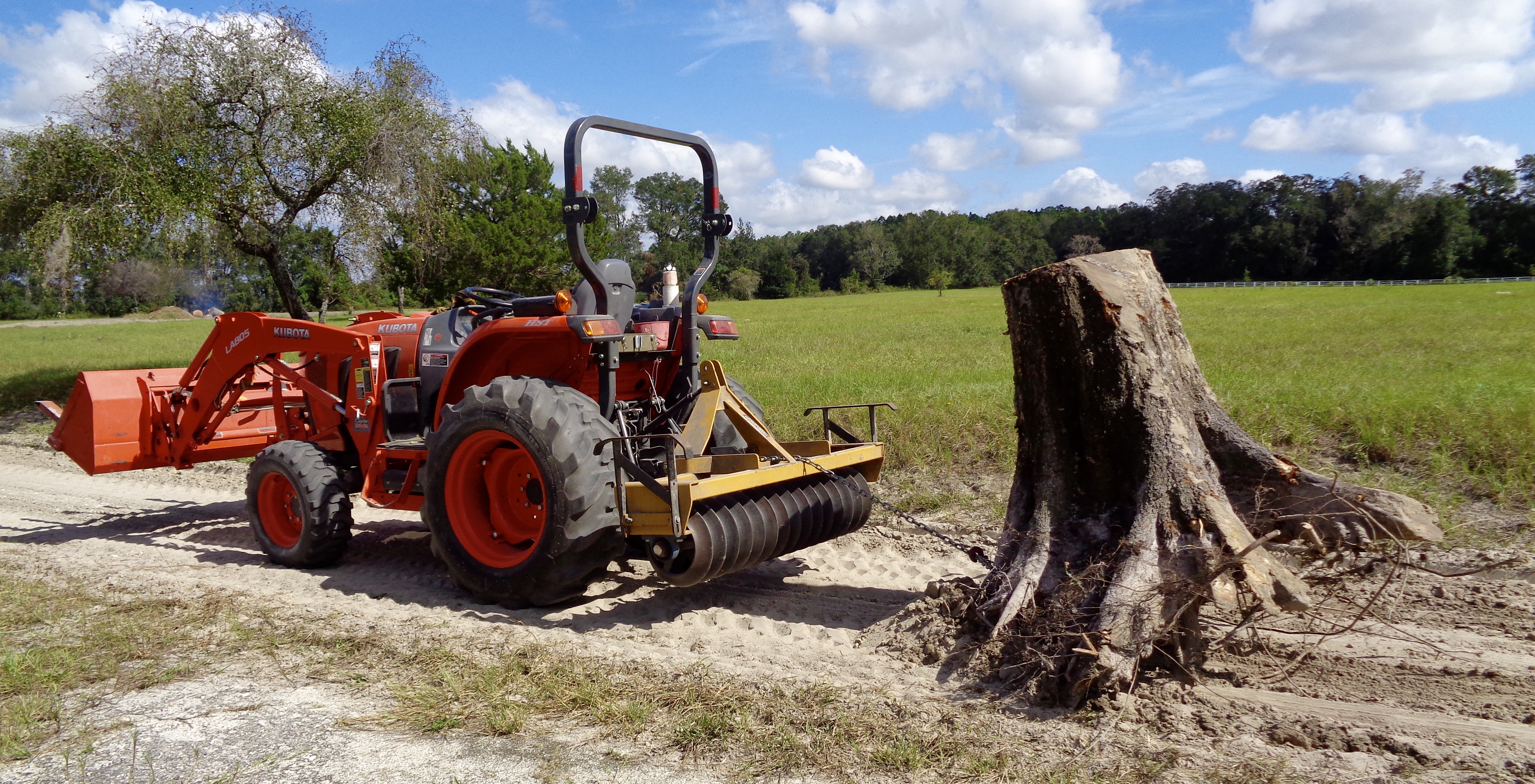

I need a powerful machine to:
-help me move logs once I cut down the trees along the banks
It does not take much tractor weight to pull large logs or stumps from the rear/center drawbar, if you do not mind the logs getting dirty.
My L3560 in photo is 3,494 pounds, bare tractor. Photo #1.
A Log Arch allows a tractor of moderate weight to transport clean logs suspended above the dirt. Good for transport to potential saw mill.
VIDEO: tractor log arch - YouTube
PHOTOS: compact tractor log arch - Google Search
