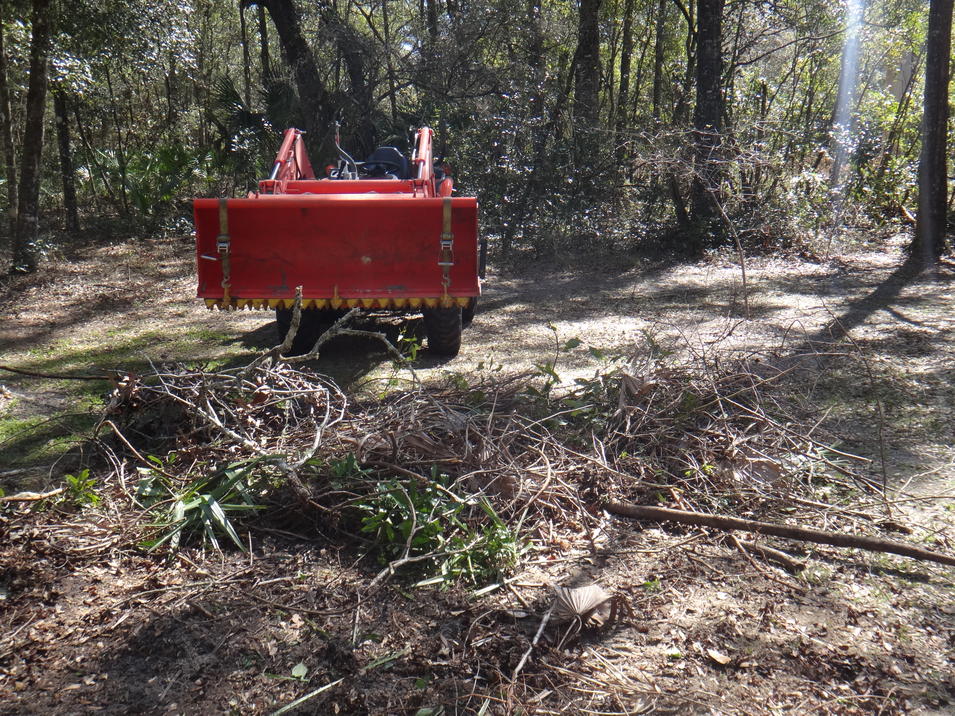

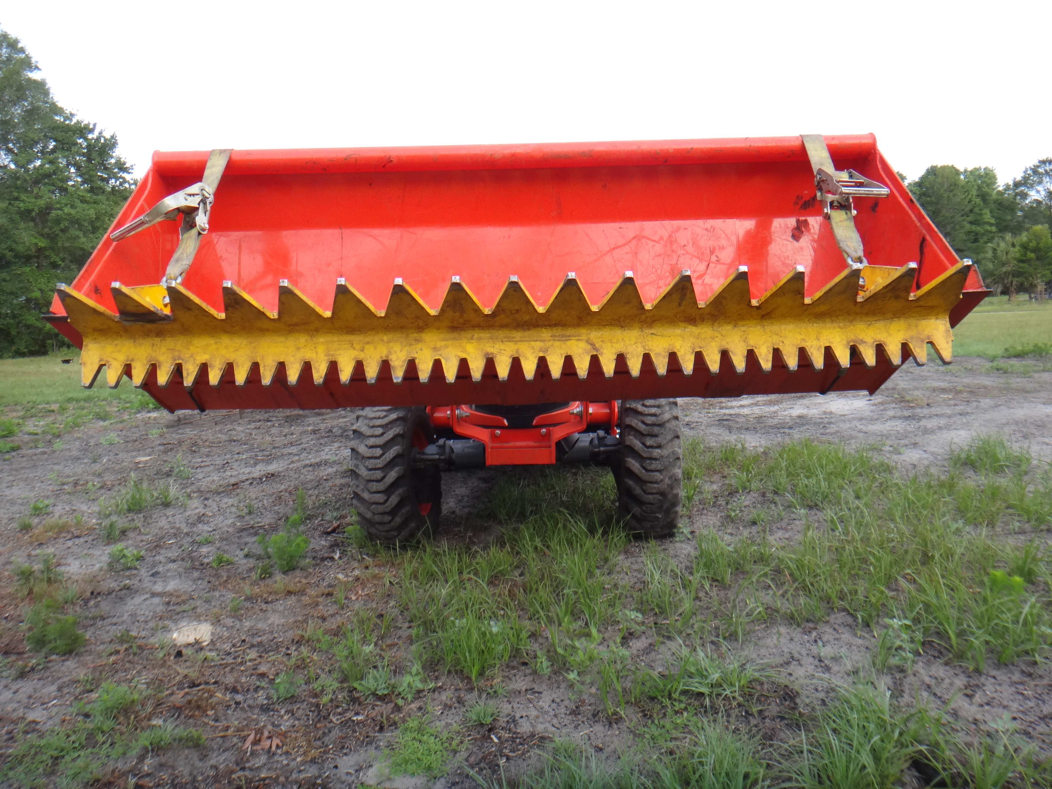

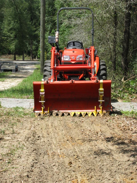

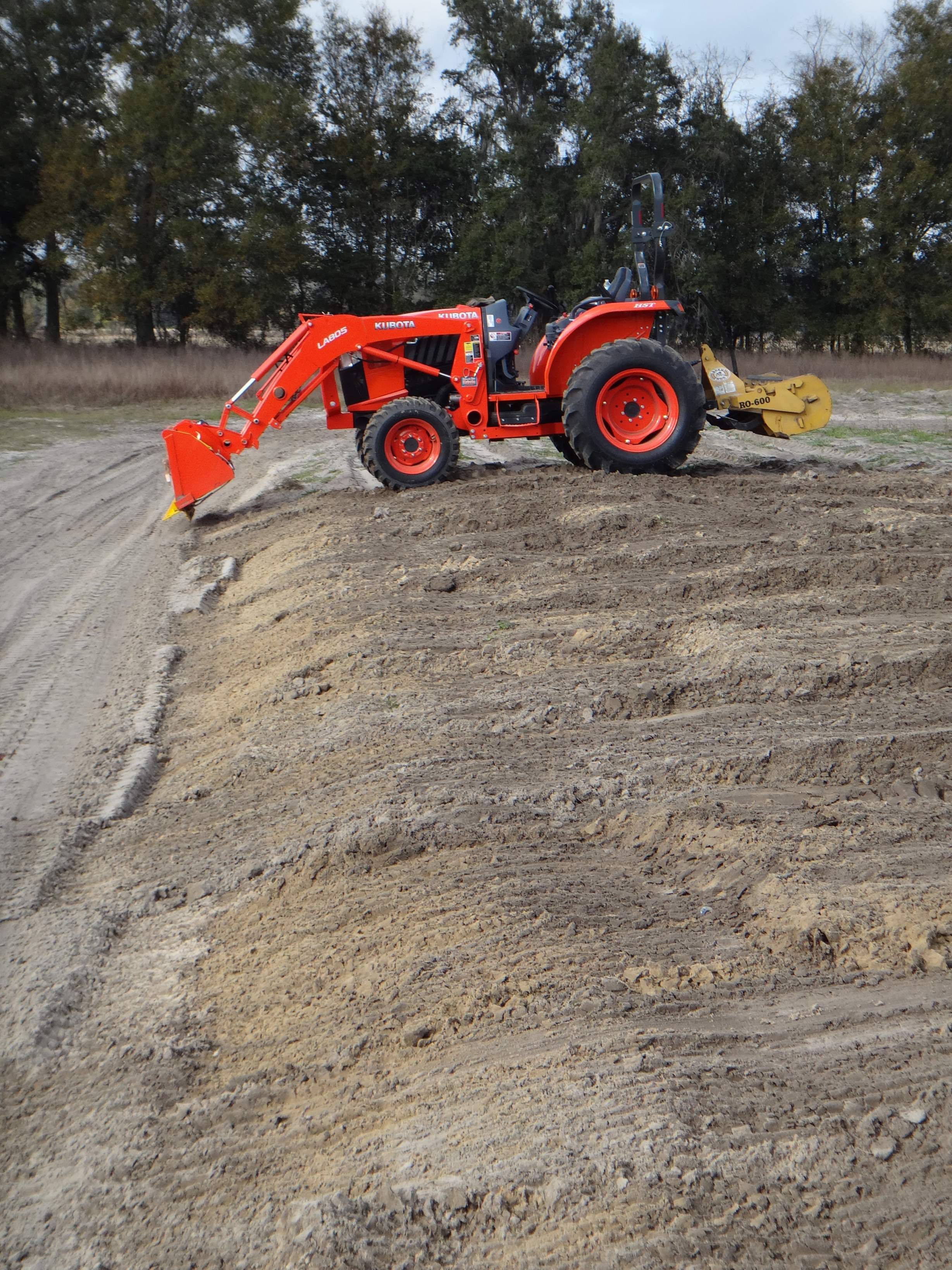

I owned a Kubota B3300 SU tractor-loader. Same specs as the MF 1526. I sold it after 400 hours because it was too light - and I operate only on flat ground.
Go with the MF1726E. You have several ground contact applications where tractor weight is EVERYTHING and you anticipate operating on slopes where the heavier machine will be more stable under load. Consider installing 2 X 3" rear wheel spacers at time of purchase, when installation charge will be minimal.
MORE: tractor for steep terrain site:tractorbynet.com - Google Search
For driveway maintenance consider a Land Plane / Grading Scraper (LPGS).
VIDEO: land plane grading scraper - YouTube
I am a great fan of the Ratchet Rake bucket attachment. Good for light grading, paired with either a Box Blade or LPGS and highly useful in woodland maintenance, especially for corralling brush.
VIDEO: ratchet rake - YouTube
Five acres is about the upper limit in property size practical for a tractor wood chipper, which are maintenance intensive after the first or second year. Property owners with greater acreage almost always burn. That includes me.
Enjoy your research and consideration. Anticipation is 50% of satisfaction.
GOOD FIRST POST.

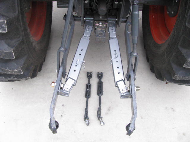

You will probably want to PUSH tractor implements occasionally in your ground contact tasks. In order to PUSH implements you need RIGID stabilizers attached to the Three Point Hitch lower links.
Cheaper tractors usually have "chain" stabilizers, which are fine PULLING but offer zero support when PUSHING implements. See photo. The chain/turnbuckle stabilizers weight around four pounds. Rigid stabilizer weigh around twelve pounds.
VIDEO: Standard vs Deluxe 3 Point Hitch - YouTube
MORE: standard vs deluxe tractors site:tractorbynet.com - Google Search

If I got this all right the "RIGID stabilizers attached to the Three Point Hitch lower links" on the Economy vs Premium models. Both have them, just the Economy has Screw in Stabilizers vs "Pin Style". Thinner Drawbar on the Economy Model. The Lower Hook up points are fixed, compared to extendable ones on the Premium Series. Also the 3 Point Hitch has about 900# higher lifting power on the Premium Series.
