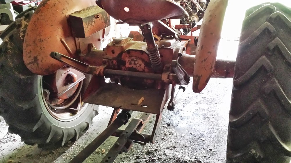

Byron Center is located in west Michigan. The Allis Chalmers is a 1947, and I know they have 3 point hitch conversions available. Attached is an image of the back end, can you tell if it has the conversion?View attachment 335379
To give more detail on the Allis Chalmers, the oil leaked out of the engine over the last two years while it hasn't been ran. Prior to that, it worked great. So it will take some work to get it going again, I am just trying to figure out if its worth my time. Am I better off just spending $3500 on a tractor that has a wide front, 3 point hitch, and live PTO? Or getting this free tractor and putting $1000 into it to get it running and converted to use 3 point hitch attachments?
That tractor doesn't even have the AC linkage attached. SO the answer is not it is not 3 PH ready. It may be hard to find all the parts necessary to put a 3 PH on it also.
