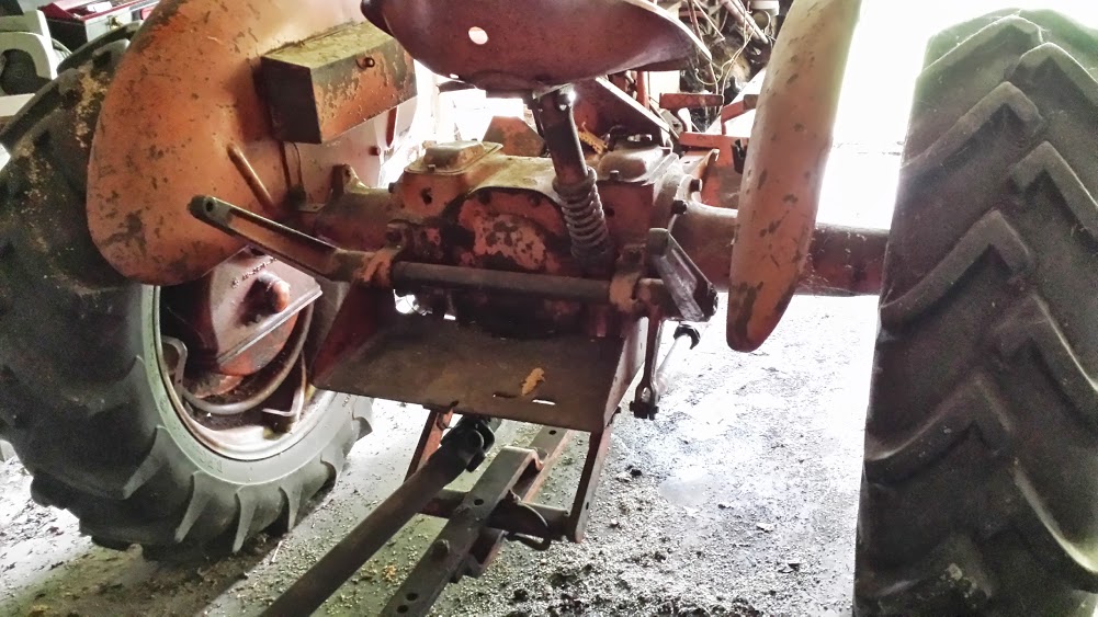

Byron Center is located in west Michigan. The Allis Chalmers is a 1947, and I know they have 3 point hitch conversions available. Attached is an image of the back end, can you tell if it has the conversion? 20130831_144514.jpg
To give more detail on the Allis Chalmers, the oil leaked out of the engine over the last two years while it hasn't been ran. Prior to that, it worked great. So it will take some work to get it going again, I am just trying to figure out if its worth my time. Am I better off just spending $3500 on a tractor that has a wide front, 3 point hitch, and live PTO? Or getting this free tractor and putting $1000 into it to get it running and converted to use 3 point hitch attachments?

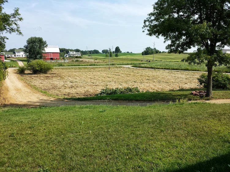

A portion of the land I have is near a wetlands area, so it tends to be a bit wet at times. No standing water but with a good rain, it can get a bit soft. Attached is a pic of the 1 acre plot after having it brush hogged. You will also see my driveway, which will need to be plowed by the tractor. IMG_20130825_110735.jpg

The WD is a nice antique, but it's not likely to be a reliable partner for your routine work... you'll spend more time keeping it running than using it. As others say, a number series Ford, or maybe a Massey Ferguson 35 or 50, or something else with a good 3 point setup and live pto would be a better choice. Finding one in good condition is more important than what make it is.
Nice property, by the way.
