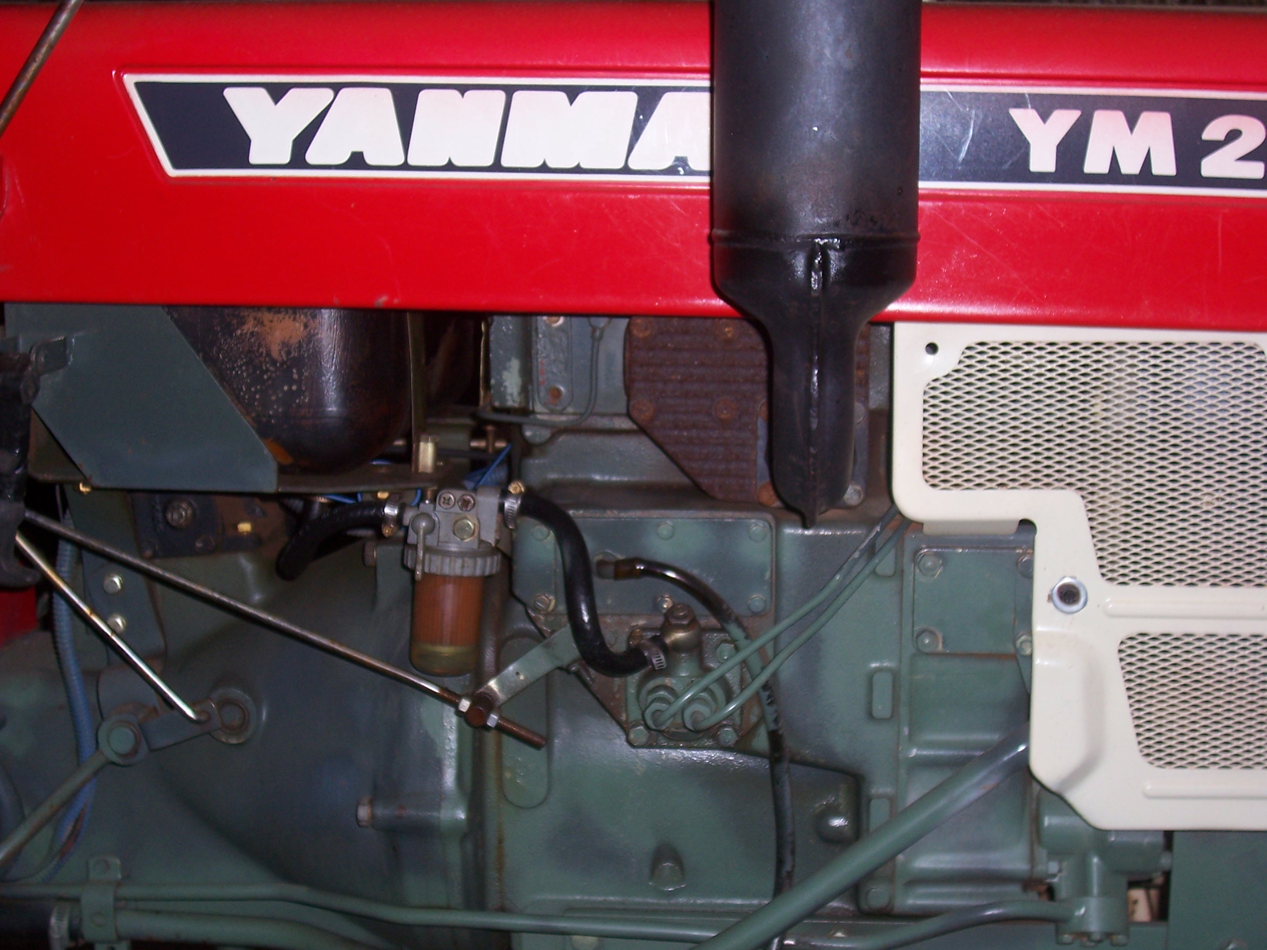

As far as blowby, there should be a rubber hose about 1/4 coming off the side of the block on the right side as your sitting in the seat. It will run down and just end in mid air around the hard hydro lines. If there is a lot of oil slobber blown on the side of the block this would be a good sign of blowby. The rubber hose may also not exist, in that case there is a fitting still on that side that it just pushes onto, if i remember right its a metal j tube pointing down that the hose should be on. Its a little above the injector pump and foward a little. I would run it up to 2400rpm, the fully ratted HP rating and drive around while looking at that tube and see if you see smoke or mist coming out of it, you can also let it run at 2400rpm and stand beside it and feel for air mist coming out, mine has just a little pressure , which i think is just from the rotation of the crank inside, but no spray mist or anything, a drip now and then but not constant. You also should put the tractor under a load and observe this weather it is a boxblade you put down to "work" the tractor or a disk in the ground or a bushhog that you set really low to tax the motor, it will let you know and if you dont see blowby at that point chances are it dosent have it.

Clemsonfor posted it to the (T) for our area. Here is a pic. of the vent tube on a Ym2000. It's the shorter Blk. hose coming out of the block above the Blk' fuel line. It's basicly the same as the US. Ym240. Throttle linkage works the opposite and I believe you only have 540 or first gear PTO. and the Grey has three. Everything else is pretty much the same. You will find all kinds of Info. on here for these models with alot of owners :cool:
