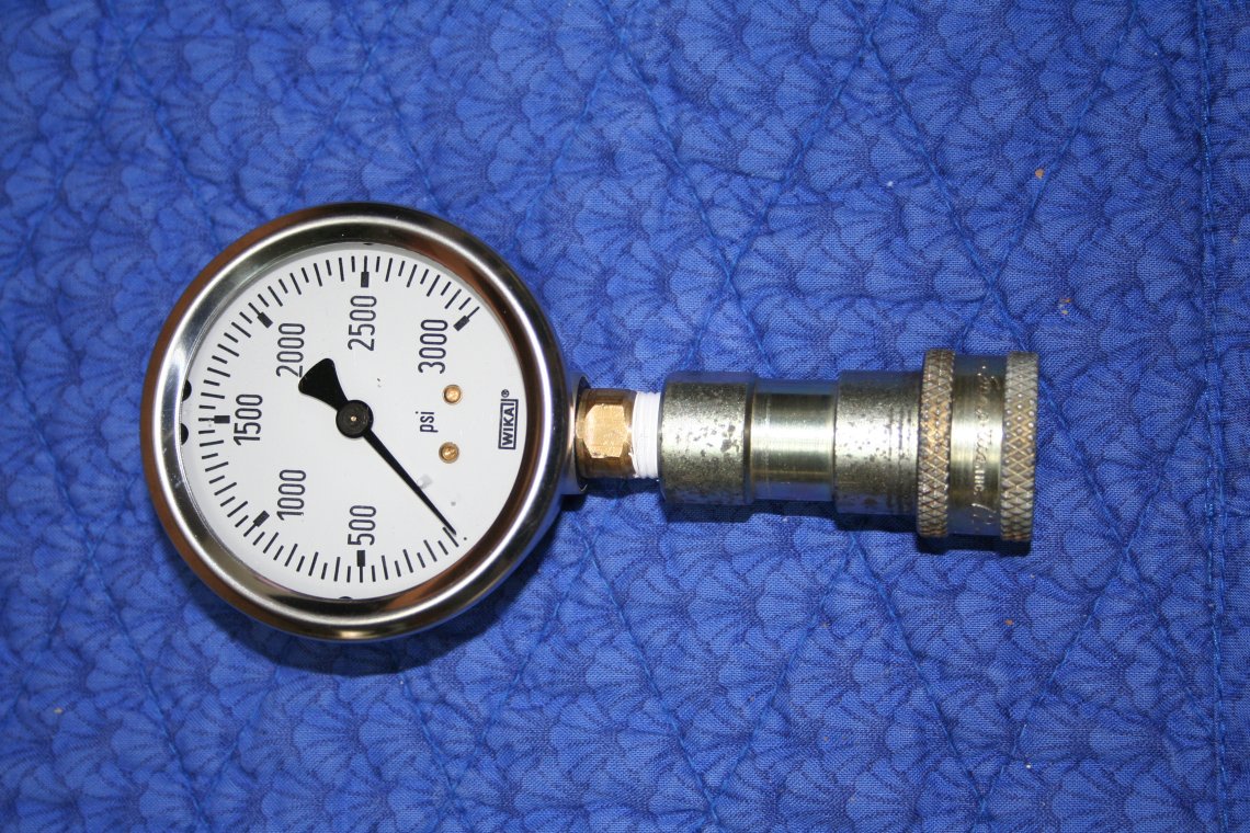

One of the first add on to your hyd system you could do is to add a 3000 psi hyd gage where you can see it or build a hyd test set like these.
You can use the hyd gage to monitor , troubleshoot, and analyse your hyd system.
