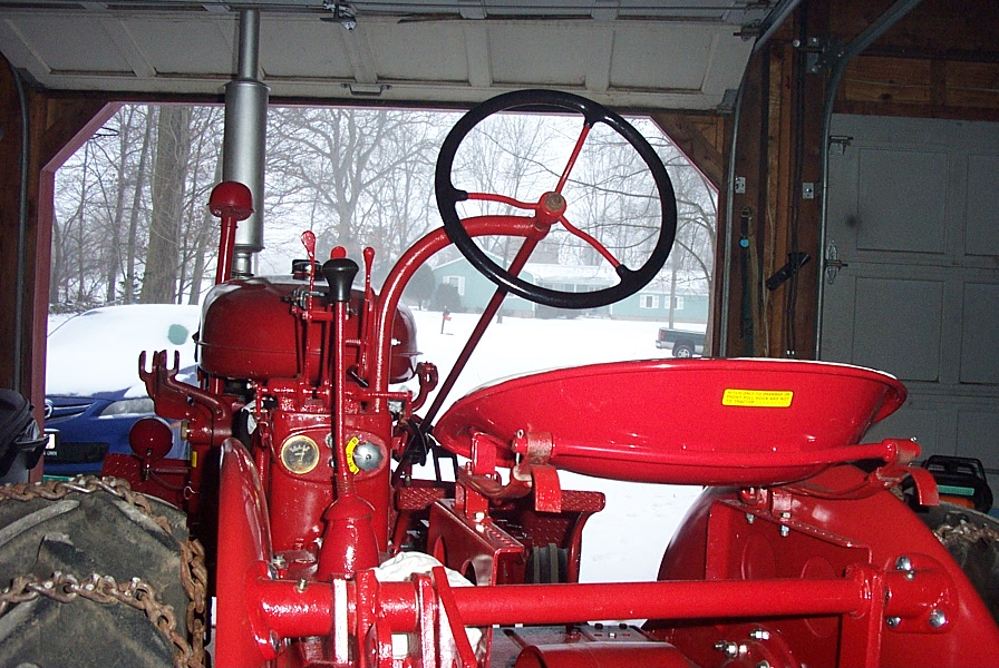

I'm looking at a Super A Farmall. It is a 1951 model and it has a new carburetor. The main problem is the tractor will not idle; the engine runs almost wide open. I'm wondering if it is the linkage from the governor or a problem within the governor????

That is the only reason for that to happen! You might want to check the shaft to see if the bushings are good and other wise remove the cover and check the springs on the weights.

There is an adjustment on the linkage between the govenor and the carb.Tractor off. Disconnect the pin in the clevis going to the carb. I believe when your speed control lever is wide open and the rod on the carb is at full throttle adjust the clevis so the pin will line up with the holes in the clevis. I will check my manual tommorrow. If thats not it, it might be your thrust bearings in your govenor housing ! I will check !
