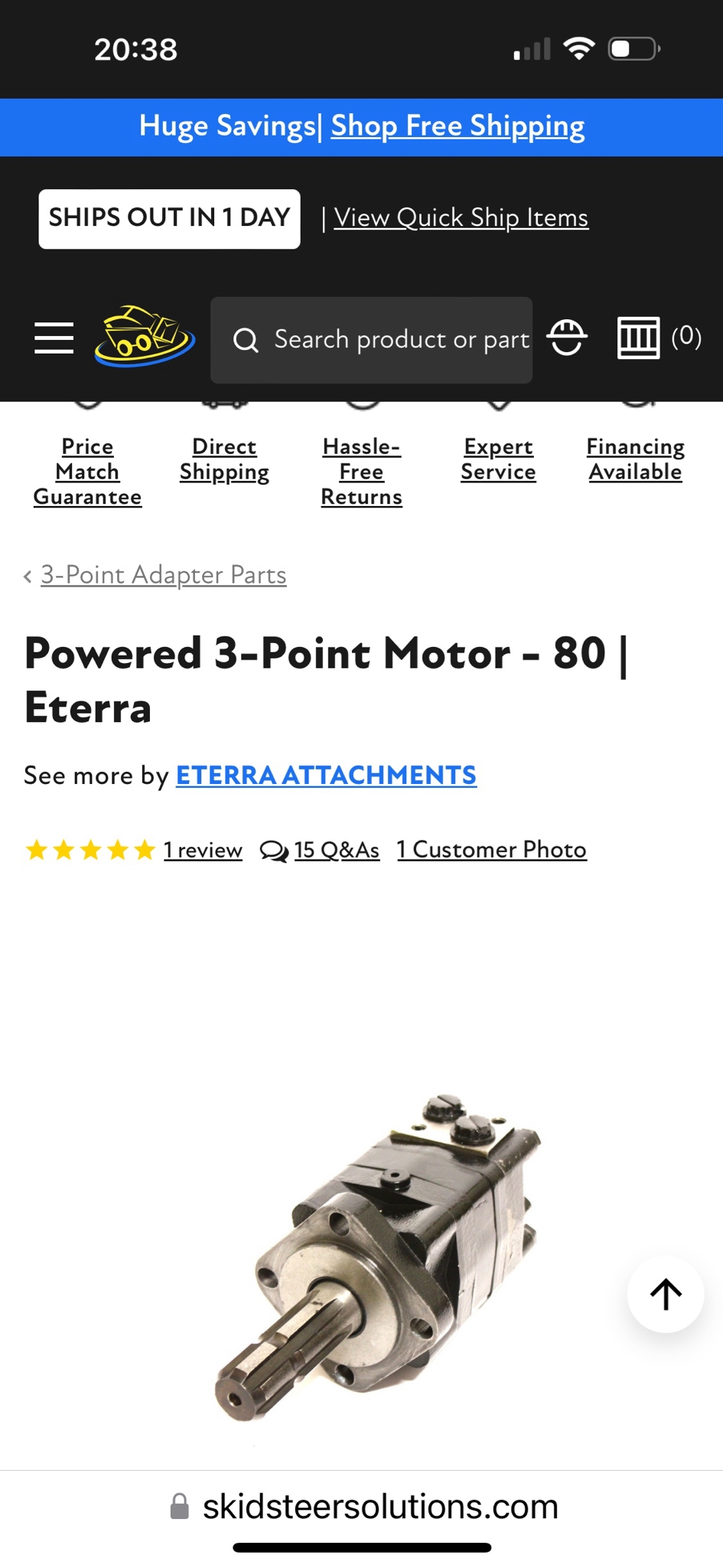

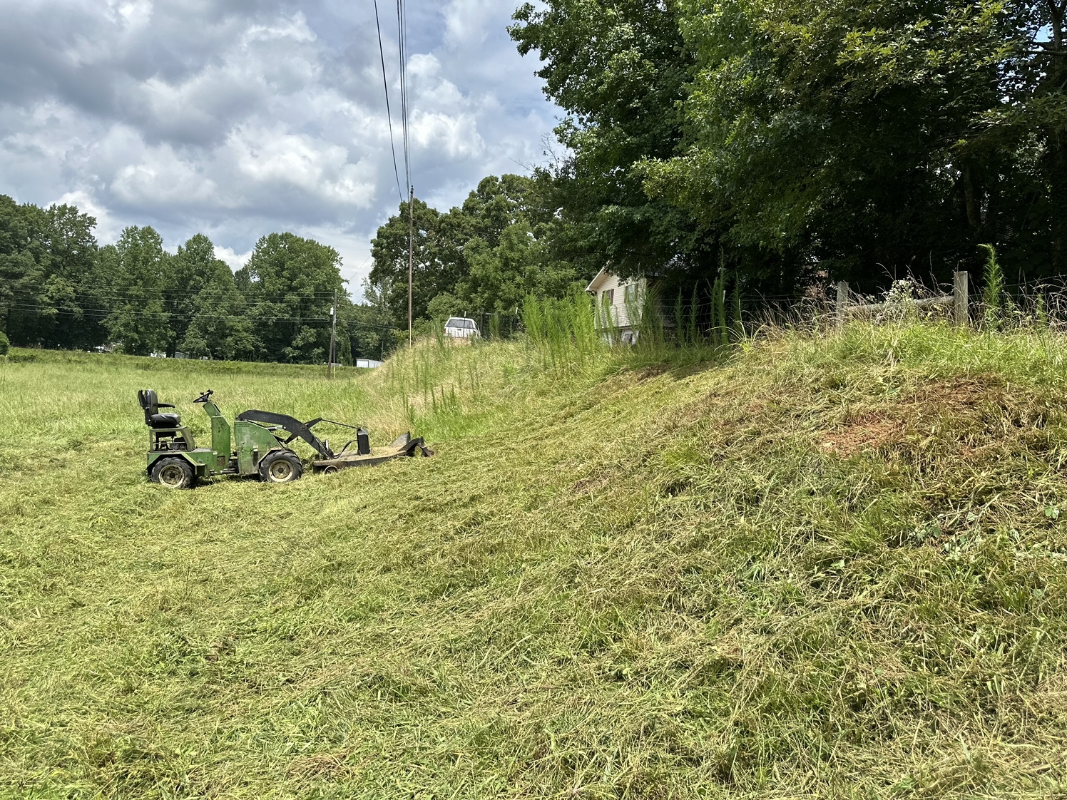

I bought this pump and am in the process of installing it on a 4 foot bush hog. It runs 400 rpm verified (i have a laser tach and verified the revolutions on this unit) on my 2425 at 9 gpm. I installed a larger oil cooler and it works well for keeping my oil temps down.
i am using the power trac 60 inch brush cutter with it currently and the temps stay good.
The pump from skid steer solutions is rated for 10-17 gpm which will work for you.
