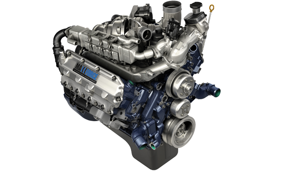

Navistar already came out with a new updated 6.0. Maxx Force... I guess it is the greatest!
