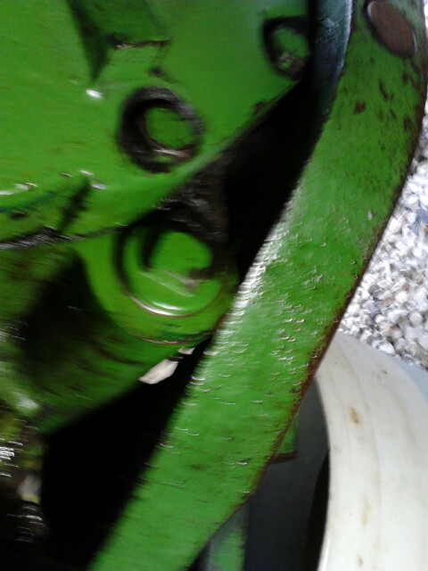

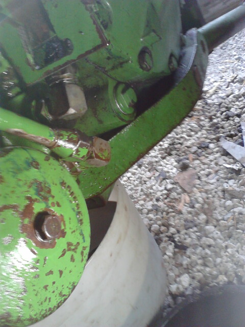

There is a youtube video on a 4020 about changing a hydraulic screen. I was told the 4010 has the same screen.
I haven't found anything about that in the book yet. The screen is behind the square plug behind the hydraulic filter.
Where does filter part # R27173 go?
4;) hydraulic screen - YouTube
