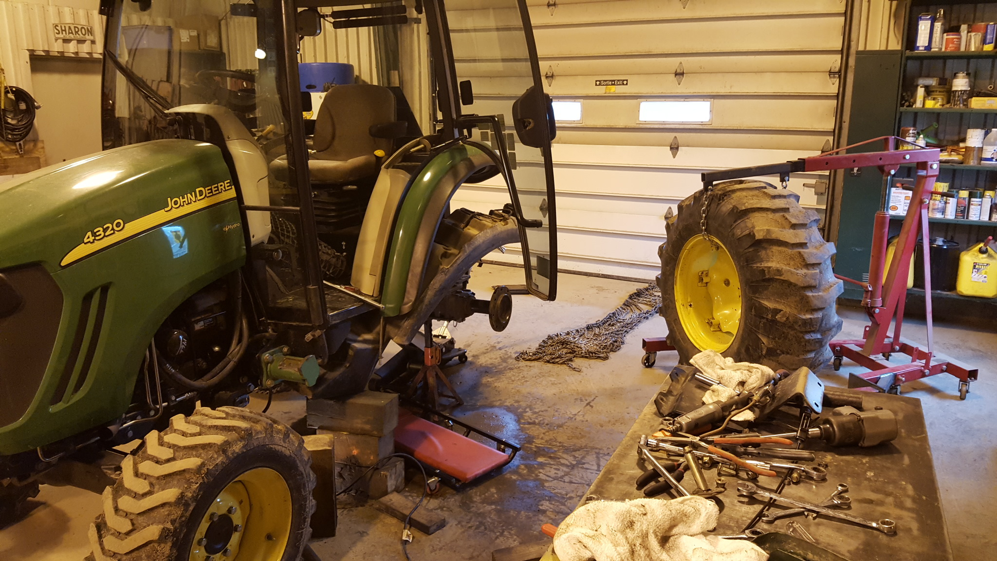

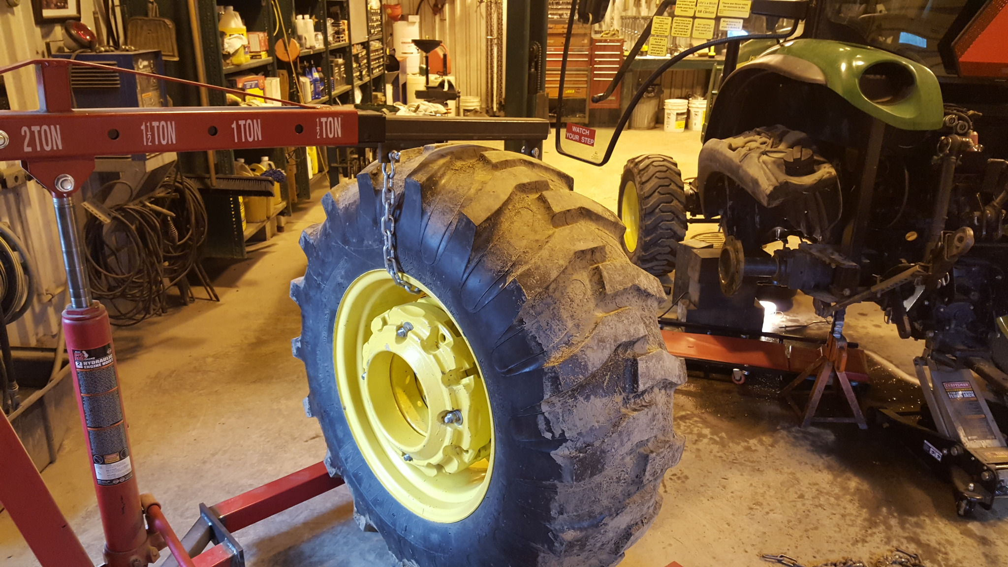

I not sure if I have a more detailed pictures. Here are 2 from when I needed to replace my fuel gauge on my JD 4320. I modified an engine lifter to do my tire changes. I swap out my ind lug tires 17.5-24 to turf tires every spring and fall. The ind lug tires are are filled with rim guard/ 550 lbs. approx. with 2 wheel weights approx. 210 lbs. plus the rim and tire weight. With out the wheel weights they were vertically stable. Now with the wheel weights they want to lean at a 15/20 deg angle towards the weight side. It makes them harder to control and move around. I modified the support legs of the engine lifter to give it a wider opening around the wheels and parallel to each other. I use a custom length of chain, screw shackles and a special 2.0 X 2.0 pc of box tubing with lugs as a lifting adapter. It works for me but like I said I do this change over 2 times a year.

I forgot to mention one thing. This works for my tractor and the industrial lug tires. If I had R1 tires this would not work because I would not have sufficient clearance between the tire and fender for the lifting adapter/ 13.6-28's. I am not sure of your tire to fender clearance. Some tractors have the tire and fender so close you cannot even use chains. At the local fair a short time ago the was a new Massey compact tractor with industrial lug tires and you could not even get your little pinky between the tire and fender. Not good.

That's a great solution. It does require a nice smooth concrete floor (which I do not have at my farm) but otherwise it is just about ideal.
