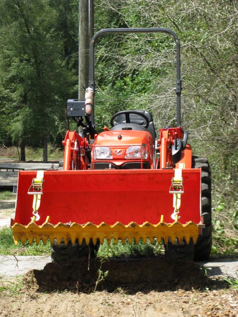

Consider a Ratchet Rake bucket attachment. You won't have to remove Backhoe to mount the Ratchet Rake. Ratchet Rake will contact ground properly and has a fast learning curve. Ratchet Rake is good at removing sod but sod will be destroyed in the process. On light tractors a Ratchet Rake is only a little slower moving dirt short distances than a Box Blade. I speculate best procedure would be to grade dirt right into the ditches, then scoop out spoil with Backhoe when grading is completed.
Some Tractor Supply stores stock the Ratchet Rake but inventory is intermittent.
You can order a RR drop shipped from the RR factory through the tractorbynet STORE, button at top of this page.
