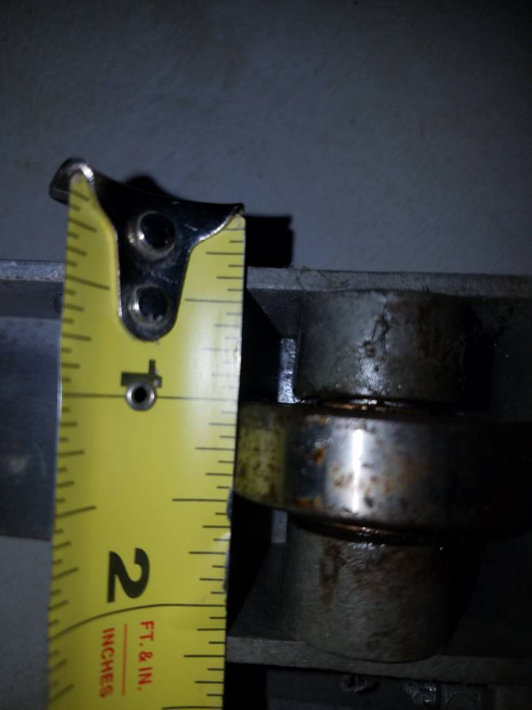

We know what the track looks like, but what do the wheels look like? Might clear up what the actual weight bearing surface is and any wear marks could provide some useful info.

For those requesting picture of wheel.
