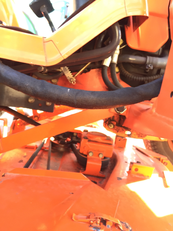

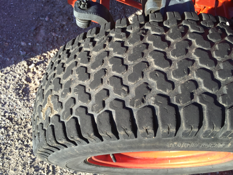

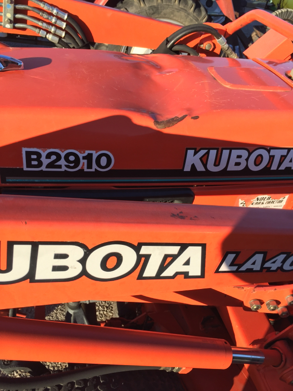

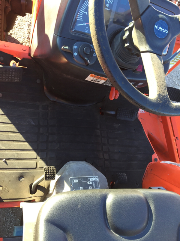

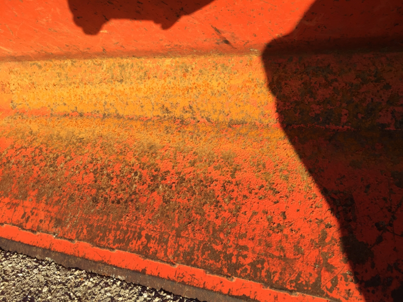

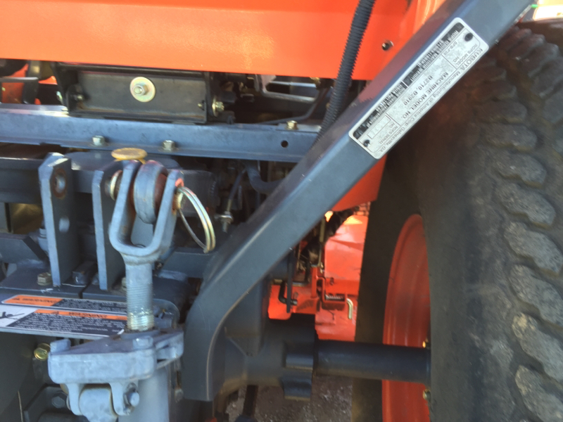

Went today and started it up. I did not drive it as I said before. Those people didn't come out at all and I was there for a good 30 minutes. Not good sales people. The hood is dented on top and it was left out in the weather. It had a new seat out on it. It started fine and sounds good. I raised the bucket and didn't hear any squalls. Bathe mower is beat some underneath but this is Missouri. Lots of rocks. Has a leak underneath. Looked like hydraulic oil.
