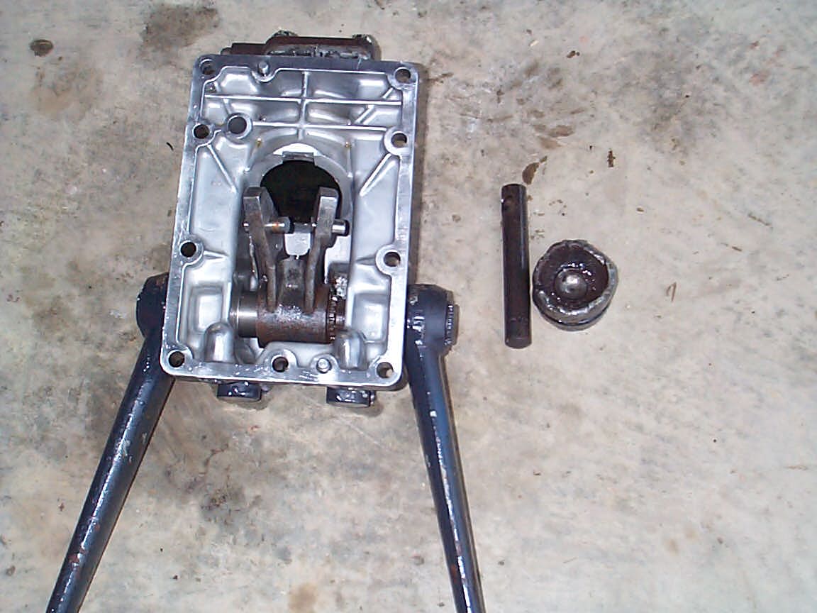

I am looking for the hydraulic lift parts for the 3 pt hitch lift system on my Iseki TX1500F
These part numbers are out of my manual but I have been told they are Bolens part numbers
1871790-rod
1871791-pin rod
1871783-crank lift
1871789-piston
1871447-back up ring (o-ring)
1871446-o-ring (p-50a)
1860727-o-ring (g-55)
1860931-o-ring (p-12)
I would also consider a used assy or parts tractor as well.

Len, we were able to mill the oversized piston down to fit the bore.
The 3pt hitch works like a charm.
My neighbor and I pulled the front differential out from underneath the tractor, then pulled the frame so we had access to the tap the bolt holes in the motor since the previous owner stripped them out when the mounted the FEL mount.
Found the splines were stripped off the frt pinion and they had drilled a hole and pinned the yoke to the pinion shaft, no wonder the tractor stays in 4 wheel drive all the time! :(
