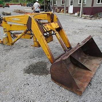

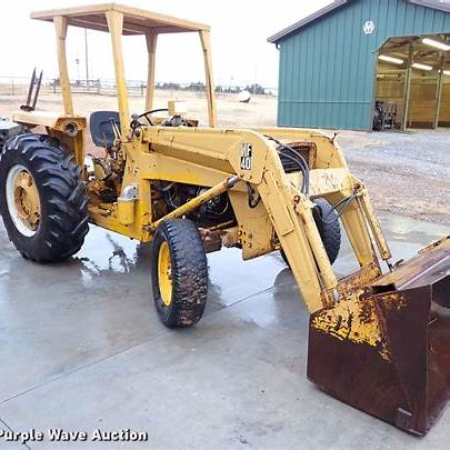

Yeah the MF100 loader came in two variations from the factory. One was the 'farm' version, with a single dual action cylinder for the bucket, and for the lift its only a single action with no down pressure. The other variant was found more commonly on industrial Masseys and were similar to the MF32 or MF34 loaders that had two dual action cylinders for the bucket and dual action for the lift. The two different versions of the control valve just bolt on the manifold of the same loader frame. Otherwise frame mounts are the same between the two variations. And for this setup the hydraulic pump is a separate unit that's driven off the engine crankshaft front mounted with the hydraulic fluid reservoir, filter etc. built into the loader frame.
Example of the 'farm' version I have:
VS the one with dual action lift of the same years:

While looking at the various MF32&34 loaders, I stumbled across mention of a model MF2135 which is a new one on me. Apparently it was the industrial version of the MF135 and sure enough, there is a dual motion version of the MF100 loader mentioned in the attachments. Surprisingly more powerful than the ag version.
Some great photos at:
